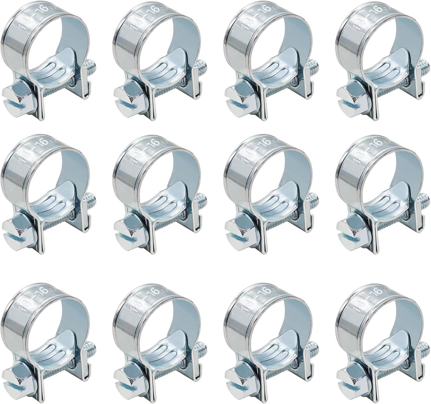

For both, I use fuel injectionclamps, they are easier on the hose than the usual screw type.
Hose Clamps Hose Clamps
