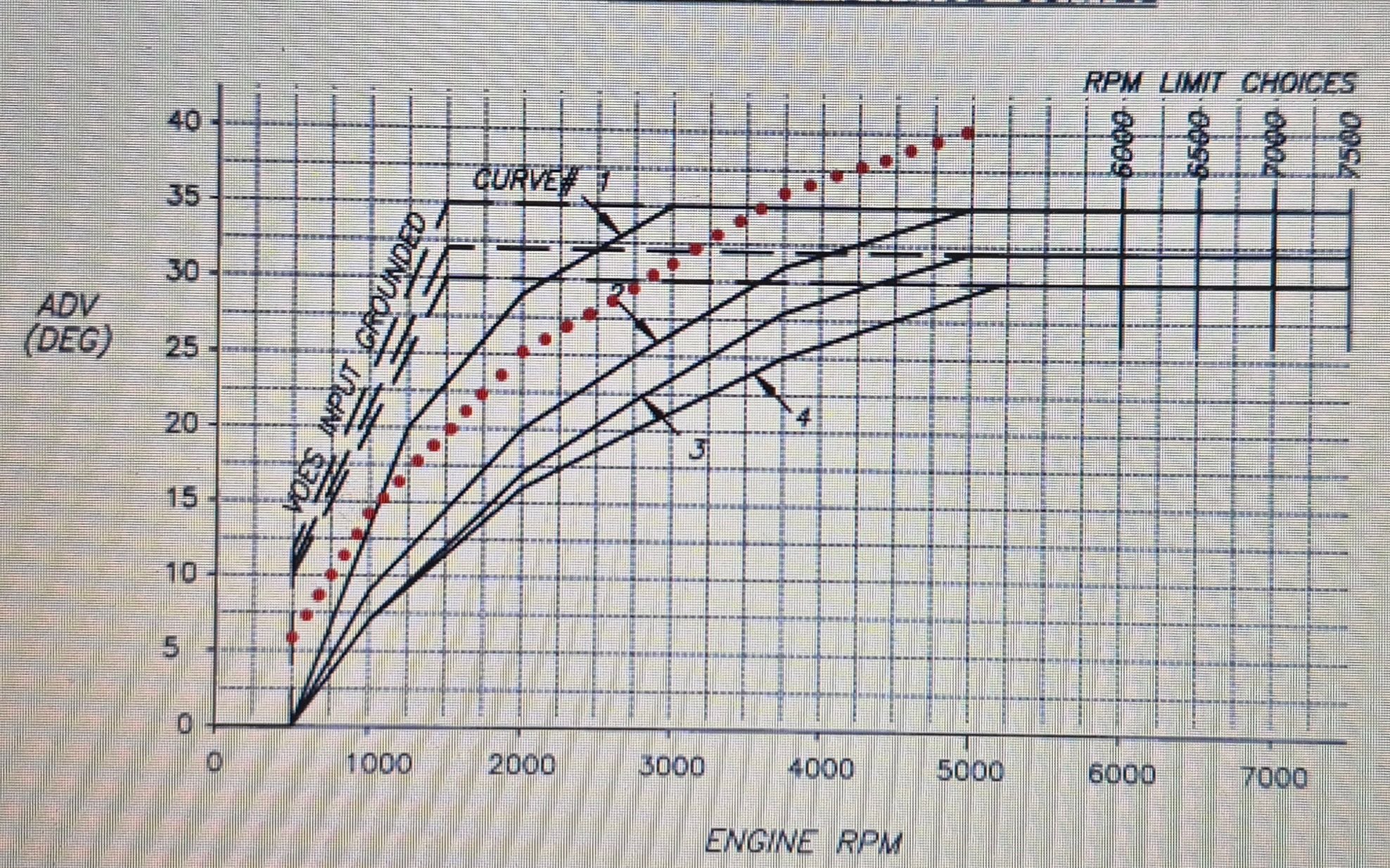

I got my patch cable back from TwiZted Biker today and tried to create a new ignition curve but found out in a phone call to Dynatek that even though the SE module with 4 ignition curves was made by Dynatek back in the day, It is not programable like the 2ki or the 2000p modules..
So I had to go back to curve 2 but advanced the entire curve by 5*.. Didn't really want to do it that way but have no choice right now. I will say by running the motor like this, there is a very noticeable difference in power.. I really like it and so does the motor.. No detonation and the plugs look really good.. Throttle response has also increased.. I wanted a little different curve but won't be able to do that till I get a 2000p programable remote ignition module..

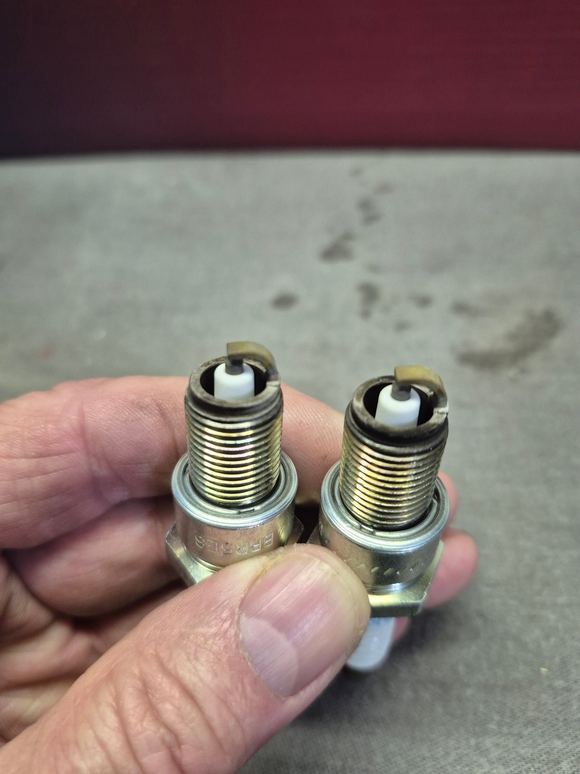

If only I new I could do this back in the day of "3 more HP" I might have hit my goal of 100/100.. Oh well, I'm way beyond that now because of the increase in cubic inches. Here's a look at the way the curve is now in the RED dots.. Each line on the pickup represents 2.5 degrees of timing which is the same as in the graph.. I might need to add a little more fuel but I want to put a few hundred more miles on the plugs to get a better reading.. Only 100 miles on these plugs.. Second pic shows timing on the strap and third pic show fuel burn..

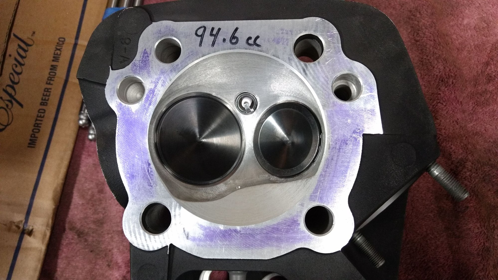

I take it that you are still running those crappy D shaped chambers. Might want to bathtub them or find a better set..
I'm very happy with them.. 1.98" intake and 1.63" exhaust with a chamber size of 94.5 cc and a set of Axtell 30 degree pistons milled to 18.4 cc domes.. It all works very well together.. I'm pretty much done tearing down and redoing this motor, although I will have to tear it down eventually, I think the cases are leaking in the rear.. Will need to remove the primary to get a better look.. At that time I'll do the clutch.. It started slipping around 3800 rpm in 3rd@WOT.. I just want to get what ever power I can out of what i have..

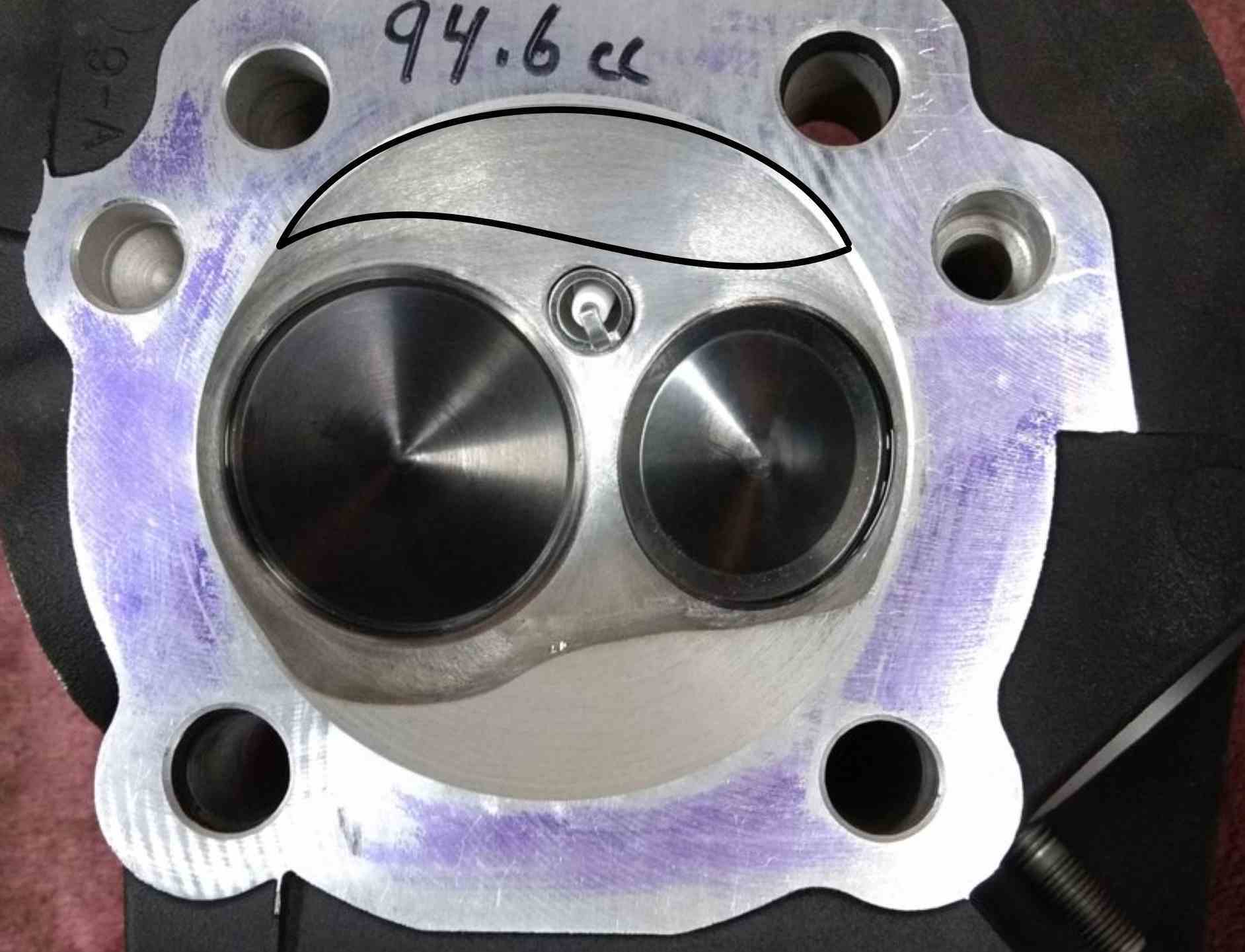

Well for me, if you are needing 40 degrees for full advance, the **** ain't burning fast enough.
Agreed.. Similar to the necessity of dual plugged Shovels because of the piston...

Fill this area in, keep the taper dome and adjust the CR to the same and I'd bet you'd be running 25-28 degrees timing.

I wasn't aware that was an option, I thought that chamber had to be opened up to accept the Pistons..
Well it definitely wouldn't work with the pistons you use but they do make tapered squish pistons.. Filling that area in has been done. The evo SE heads have squish both sides. Branch used to weld up the D shaped heads and kidney shape the chambers.. He used a flat squish but but they could be tapered. IIRC Axtel had pistons.
