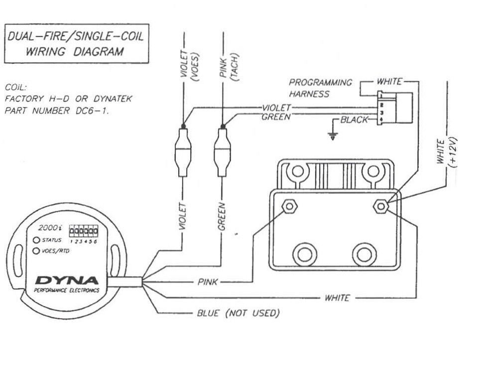

Originally Posted by shotnbeer1@comcast.net
Ive been in the process of installing the dynatec 2000i. The current unit thats in the nose has 3 wires that go to a 3 prong plug. From there it goes to the ignition module #32406-91a. The instructions for the install on the 2ki does not say wire to it. I want to clean the wiring up and remove things that aren't going to be used. Is this eliminated once you install the 2Ki? I am concerned about the heat in the nose cone. Normal operation temp for the evo are around 200 degrees give or take. Thats oil temp. I haven't put a heat gun on the cone but should I change this thing out every 5 yrs or is there a mileage related to it failing. Like every 10 thousand miles. Just trying to get a hold of what Im getting into. Thanks

Please ignore the flat, 4-wire connector. It is for a programming cable.

To answer your question, yes that module is eliminated. the 2000i is fully self contained and does not need that ignition module.

Originally Posted by t150vej
Ya I got that. So removing the existing ignition module is ok? Thanks

Yes.....

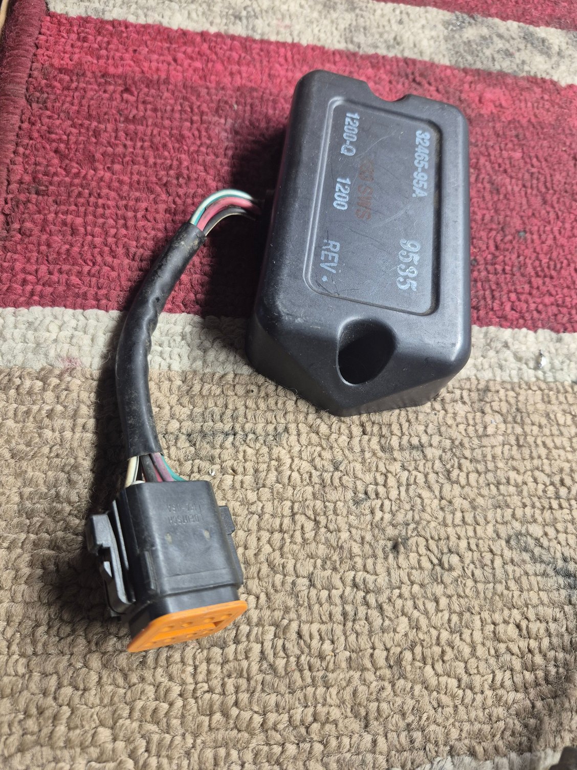

Originally Posted by Racepres
Since it is Unused with the Dyna...absolutely..Now you have Trading Material..have a Friend searching for a Stocker Currently!! I have No Problems with them ..
@Racepres ​​​
What year? I have a 32465-95a 1200 Q stock ignition module 95 and op, Deutsch connector if it helps..
Edited: It's for an 883 sporty but has more advanced ignition timing.. They work very well in an 80"er...

@Racepres ​​​
Yes...I have Preferred Sporty Ignition Modules in Big Twins since the First "black boxes"...
I am pretty Sure that is the one he Needs... 3 wire...vs Later 5 right.. ... or??? I may be wrong on years..

It's a 8 Pin Duestch connector with 7 wires..
