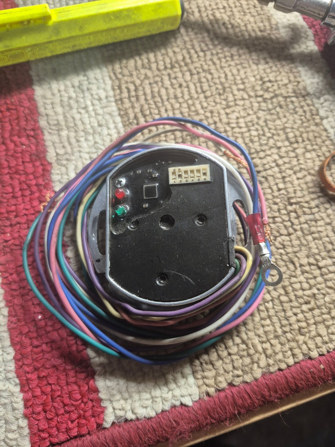

I`v experienced the sensor in the cone failure several times on my `89 Softail, finally the module gave up the ghost.
I replaced it with a dyna 2000i, it`s been in there about 5,000 miles so far.
I have read a lot of posts about the oem type sensors failing, but I don`t recall any posts about failures of the dyna unit inside the cone, but I have read a lot of posts speculating about failures because it is in the cone...
Old Apr 9, 2026 | 07:57 AM
98hotrodfatboy's Avatar
98hotrodfatboy
Posts: 21,091
Likes: 7,611
From: Poolville
I had 2 fail because of heat.. The first one I sent in and they only charged me $150 for a replacement.. That one failed as well 7k later.. I guess my motor produces a lot of heat.. Hi Comp.. The green led no longer works..

Originally Posted by RHPAW
This.
I can tell you the Screamin Eagle module is junk. No rev limiter, and mine took a **** on the road last year.
Dyna in it now, and it has more dip switch variables to dial it in, including the rev limiter.
They are made by Dynatek.. Very good unit.... RPM TO 7500....
