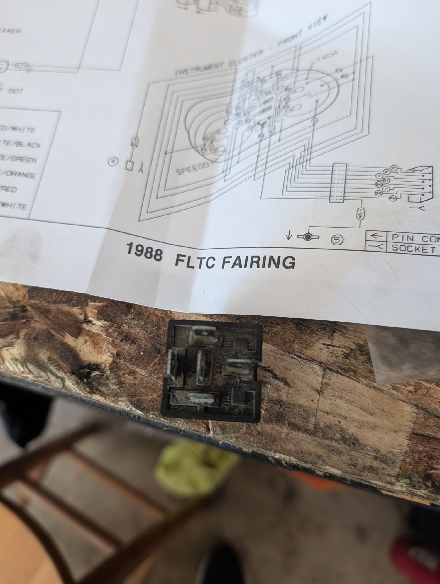

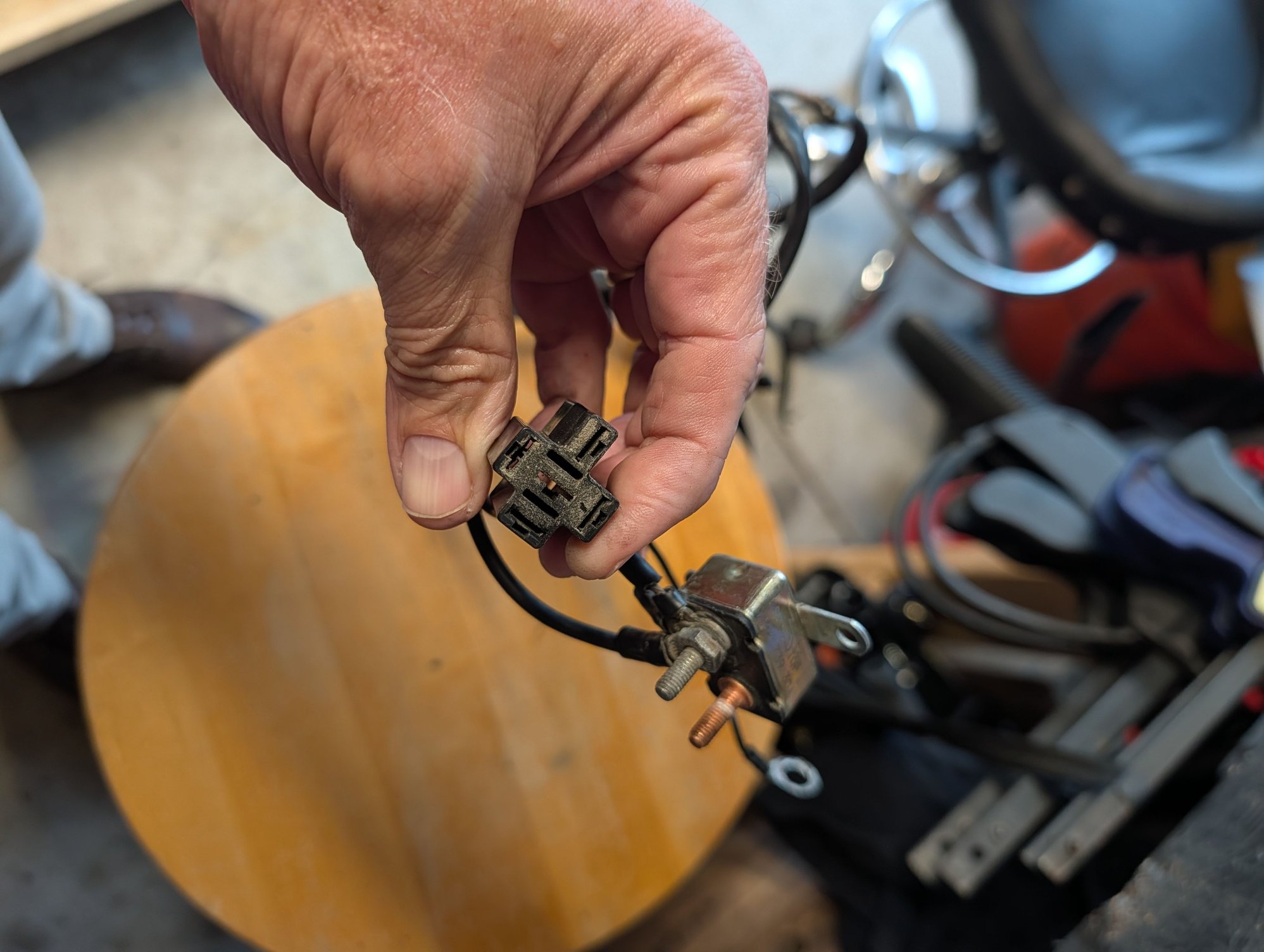

Good and bad news on the wiring harness. I got a wiring harness from EBay that said it was from a 92 FLHS, it is not, that's the bad news. It doesn't match any of the FLHS wiring diagrams I have found, and instead of a headlight plug, it has what appears to be a relay plug.
The good news is that it fits the 12 pin connector coming from my main that my current front harness is hooked to, so I will be able to repin it and use it.
Has anyone seen a relay in the front harness and can point to a year range it may have been used?
that is the headlight plug in your hand.
Its the same on my 92.

I guess I'm used to the 3 prong headlight plug. This was plugged in it when it came.
Sure looks like a Bosch Relay plug...my '94 ain't like that...(has normal headlight plug)
Your right- both of you- my mistake. Sleep deprivation sucks!
But when I saw the picture on EBay, it looked like a headlight plug to me too!

I just took a look at my manual for 92 flhs- should be 3 wires to the headlight- black- /white- /and yellow. Hope that helps?
