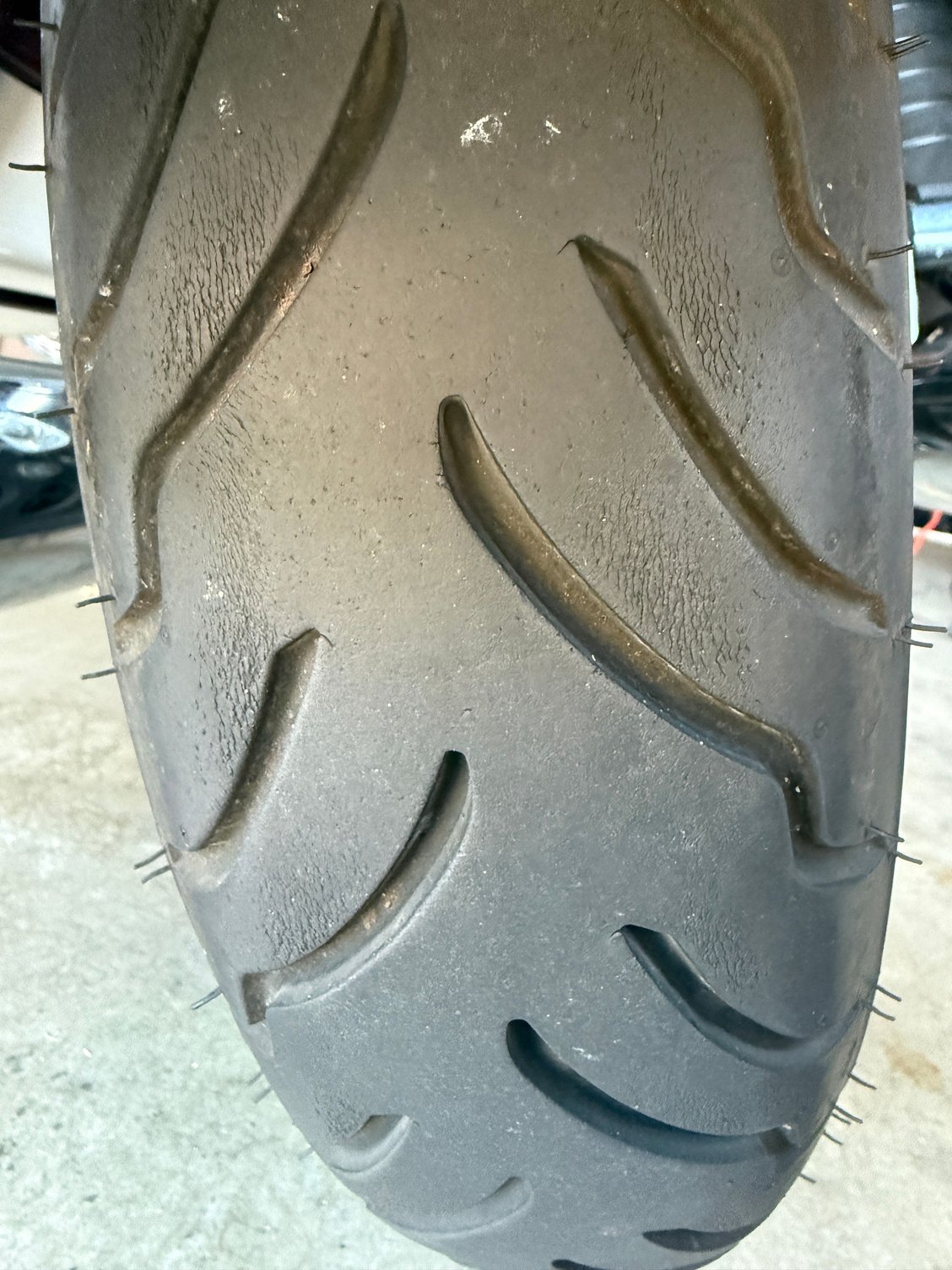

And oddly my rear tire. Due to a faulty tire gauge I accidentally had the back tire up at 55 psi for a few weeks of testing. No wonder why it was feeling funky back end. But the tire had some cupping going on even on both sides. And these weird texture things. Need to check my alignment rear hard make sure it isn’t off. Belt is tracking fine. But I might just change it. 5 years old now and about 3500 miles on it. (American Elite I) $450 is cheap insurance.

I did however order new tires tonight. Whitewalls this time. I showed the rear tire to the lead wrench and he said yeah it’s not a good thing. the funny scuffing. But he’s seen the Elites do it. It’s right where the hard compound center meets the softer sidewalls. Getting a set of Avon’s he recommended for more of my riding style. Cobra Chromes?

This is what my back tire looks like at 3k miles. Dunlop America Elite. Always ran 40 psi other than the few days of the faulty gauge. And it’s cupping as well. Alignment seems solid.
the wired parts are the transition points apparently.
