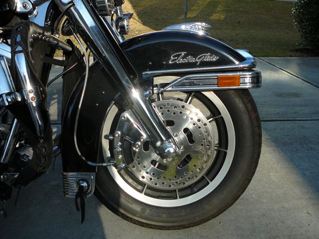

Just Google "harley caliper adapter" and you'll get a bunch of hits. I used the Bikers Choice adapters ($50) because they are just flat chrome with no markings or lettering on them. I don't remember where I got them, but they are available here:
http://www.shopwizardscycle.com/bike...eradapter.aspx
I installed the H-D "Stylized Chrome Calipers" 4-pot units on my bike that I got for a song on eBay, but they are no longer made. I think they look great - they have "Harley Davidson" embossed in black on them. They use the standard 2000-up H-D pads and pins, and they stop the bike far better than the ugly old single-pot black stockers ever could.
You will need longer brake lines, because the adapters move the caliper down about 2" from the normal position. I would suggest installing the calipers and then measuring the lower line length you will need. I bolted mine into place without the front wheel attached to take the measurements. I went 2" over stock and that was just about perfect for the H-D calipers I used.
Don't know about your bike, but I also had to install a completely new splitter under the triple tree on mine, because the stock unit had the small upper steel line to the master cylinder (fugly!) permanently attached to it, and I wanted to use SS lines anyway. I ended up replacing everything with Russell SS lines and chrome fittings. They weren't cheap, but they look and work great!
Here's what they look like on my bike:
