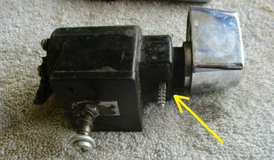

This is off a later model and the pin is made different, but in about the same position. Give you better idea of "where" it's located.
