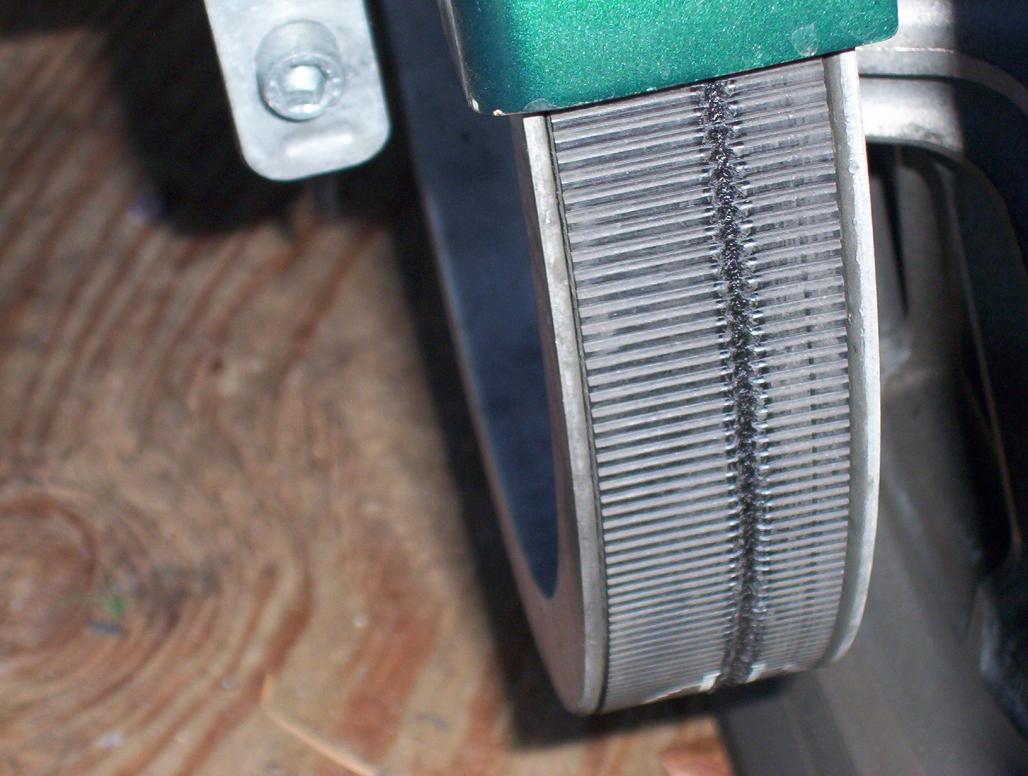

I was doing some maintenance today and happened to take a look at my drive belt. I noticed this line that doesn't go thru the belt, but goes all the way around the circumference of the belt. It looks like the belt has been dragging on something during it's rotation. I can't remember the last time I looked at the belt so I don't know how long it's been that way.
Anyone have any idea what caused this?
Thanks-
C

You need to look at where your counter shaft pulley is and make sure nothing is stuck in there. I had a fuel return line on a Ca bike do that to a belt once. It was the line that went to the evap canister.

Yeah, it looks like something was rubbing on it. Go over everything looking for something that might be rubbing. Especially check under the covers. Get a mirror on a stick if you have to. It might have been a rock or branch or maybe a screw or bolt on one of the covers, or the lower cover.
I don't think that belt is shot. I would run that belt. The load on the belt is not with that line, so I think the chances of it breaking because of that are slim.

Take your belt guards off for a closer look. Something has either got lodged where it shouldn't be, or come loose. It ain't good, that's for sure! If you can jack the bike up just turn the wheel by hand, and listen for something purring. Best of luck.
I have just replaced my belt after it suffered stone damage, although I did use it for around 4k miles before the wound started to spread out. If you can cure the cause of your damage you can probably carry on riding with it.

I'll tell you exactly what it is... Mine's been like that for 40k mi and counting.....
Take a look at your transmission vent tube. I'll bet that the hose is piinted down and rubbing the belt, or had been at one time.. Its hard to picture a rubber hose doig that to a belt, but it will. I know first hand.... I'd just move the hose and ride.. It's not damaged..

I actually solved 2 mysteries today. The first was what was causing the belt damage. The other was where the acorn nut ended up that I dropped off the back of the tank mount when I was putting it back on 3 weeks ago. The nut fell out of my hand and never hit the ground. I couldn't find it and was in a hurry so I just replaced it with a 3/4 nut I had laying around and went for a ride thinking the nut would vibrate off and then thought nothing of it again, until today when I crawled up under front belt pulley and found the nut jammed in there.
It took a little prodding but I finally got it to fall out a hole on the right side of the pulley. The nut looks like it's been bounced around a bit, but I didn't see any obvious pulley damage so I think as long as the belt holds, I'm good to go.
I love it when I win.
