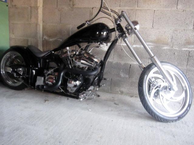

Here are some pics of my bike. She is running!
Attached Thumbnails Starter/solenoid-009.jpg   Starter/solenoid-007.jpg
