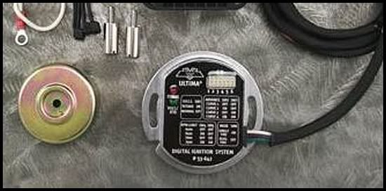

I'm running an Ultima Programmable Ignition with their single fire coil. This ignition module is actually a Dynatec ignition that's been re-branded as an Ultima. Jireh sells these (under the Ultima name) as a complete kit (coil, wires, and all) for $154.00 with free shipping.
It's here:
http://www.parts123.com/parts123/yb.dll?parta~dyndetail~Z5Z5Z50000135a~Z5Z5Z5DCXFF~ P154.95~~~~S32L14PKU668190214980k~Z5Z5Z5~Z5Z5Z5000 0123a
Here's some comparison photos . . .
The Dynatec . . .
The Ultima . . .
And here's the installation manual that comes with the Ultima:
http://www.ultimaproducts.com/53-643_53-644.pdf
