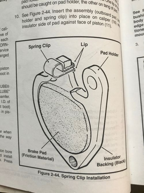

+1 on this. While brake pads do move around a bit, with the spring clip in, you shouldn't be able to hear it. That spring clip can be put in upside down; it looks like it's fit in there correctly but then it doesn't do anything to stop the pad from moving all over. Make sure the spring clip is there and make sure it's in correctly.

I had this problem after installing new pads in my 1991 FLT. I put clips in backwards and it rattled real bad, until you put brakes on. Noise stops immediately when you apply front brakes. I would say the clip is definitely installed wrong or not installed. The manual has a photo showing which way the clip installs.

Hey guys - I had the same rattling front end on my 1996 Electra Glide Classic. Acquired it used and thought the fork oil was low.
It was actually the Spring Clips. They were in there but "unclipped" - they would have to have been installed that way. In the diagram below, the bottom of the clip lip wasn't sandwiched in between the Pad Holder and the Brake Pad. It was just extended over the "other" brake pad(?) So....anyway, after purchasing new Spring Clips and installing as shown below it's like night and day. So quiet.
Ride Safe-
