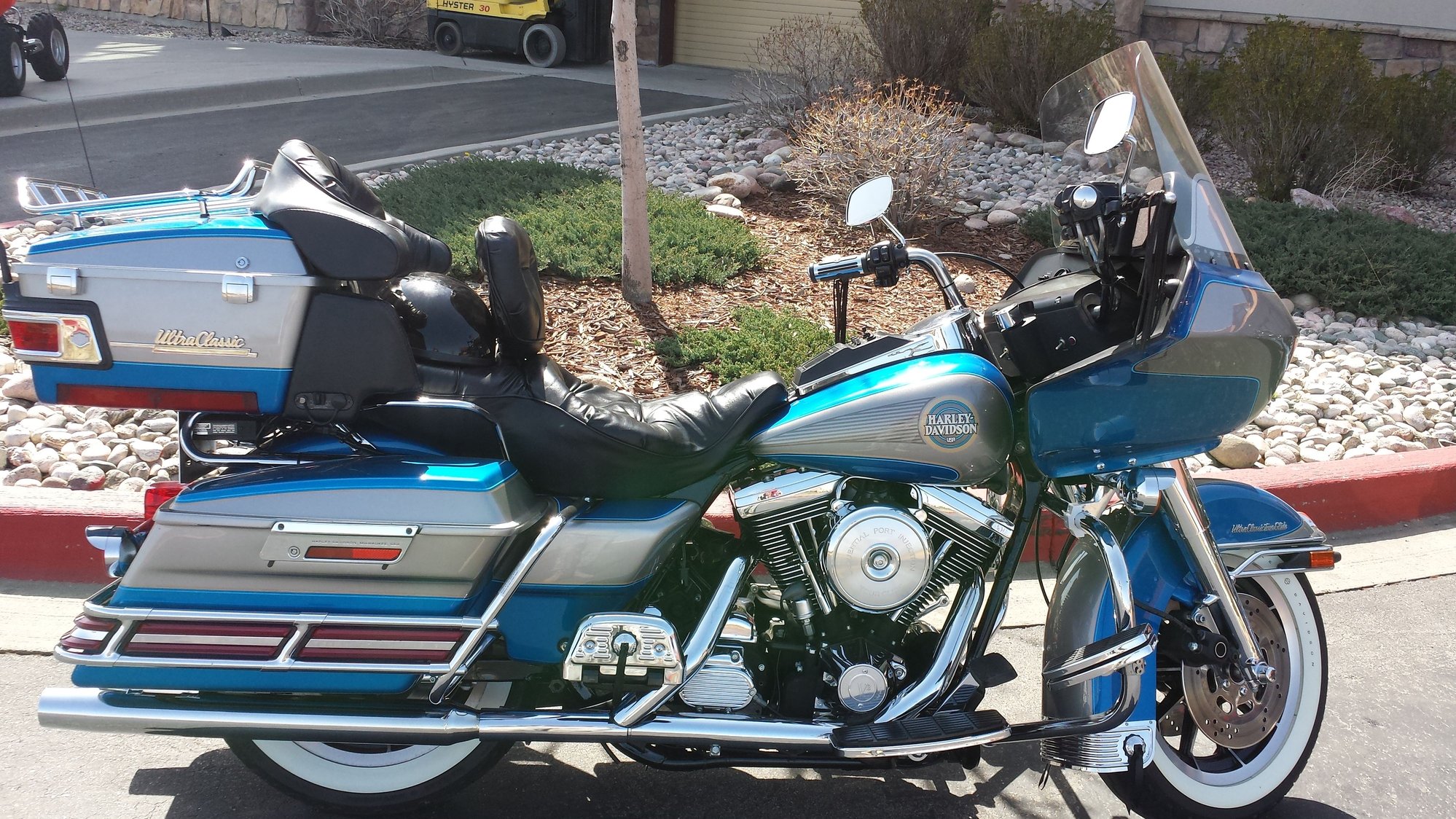

My converted 89 FLHS to FLTC

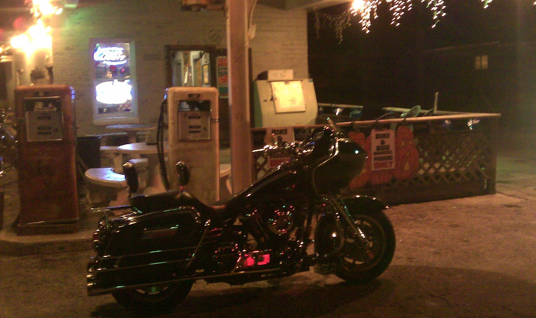

here is my FLT its a 91 (bottom breathing EVO) but I love here any way!

What the hell huh? I mean it's only a 9yr old thread. Nice looking scoot DG.
