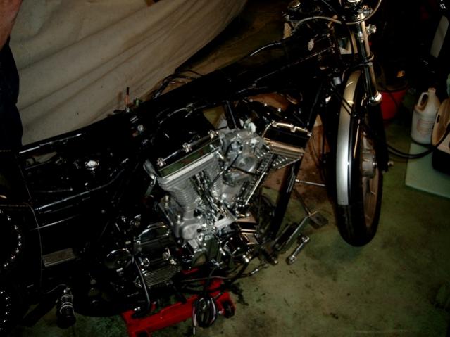

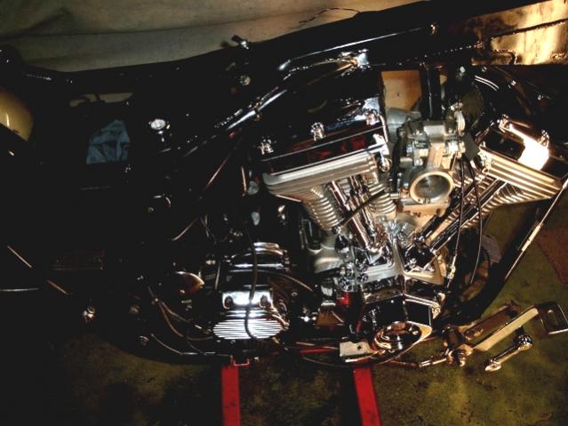

Hi all just got back from work time for the bike; got the engine in the frame and adjusted my front mount. [ATTACH][ATTACH]Fxr El bruto-14.jpg[/ATTACH][/ATTACH]
now time for the new clutch, old exhaust and wiring, tomorrow I can install the tank and do the first start
