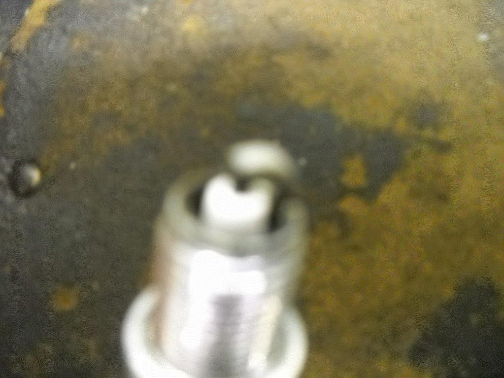

here's some pics sorry for the crappy quaility but they give a good idea of whats going on.light one is the rear and the dark is the front.

I believe you mentioned that you are running dual fire system.
Is the proper spark plug wire connect to the correct spark plug?
Does the black appear to be glazed, powdery, wet, or oily?
The white appears to white, ie running lean. Is it glazed over? If it is then your problem could be an air leak in the rear cylinder, which is over compensated for at the carb(tuned rich) there fore making the front cylinder run rich.

I have the wires correctly hooked up acording to the manual.The black is dry and carbon fouled and the white is just like a brand new plug out of the box.The bike pulls hard under good throttle but when trying to mantain a steady speed under 40 it starts to miss and pop a little out of the pipes until I give it more throttle and it clears right up and accellerates smooth.

HD's normally run the other way round, rich rear cylinder, lean front cylinder.
I agree with Spanner, you need to check the timing. While you have the nose cone open check and make sure the trigger is indexed correctly and tight. Get another trigger and compare the two, or just try running a different trigger. I had one drilled off center once and it was a nite mare figuring that out.
Make sure that you are using the correct timing marks on the flywheel, HD had several different marks and used them in the same year engines.
Are pushrods adjustable?
Popping out of exhaust usually means rich condition, fuel is burning in the exhaust pipe, since both plugs fire at the same time the one firing on exhaust is igniting excessive fuel thus popping out the exhaust. This I believe to be the front cylinder.
When you accelerate the fuel is forced into the rear cylinder(Newton and all that), thus making it run normal, at cruse < 40 the fuel distribution is totally dependent on the carb/intake system to supply equal fuel to the cylinders. I believe this is where you will find the culprit. At 40mph you are still running on the idle circuit of the carb, you need somewhere around 60mph to get to the main jet fuel circuit.
What really worries me is the white/lean plug. You could actually start melting pistons if running hot. Beware of a silver metal flake looking insulator.
