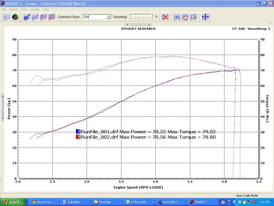

Got my parts to machine shop today and talked with Vic for an hour and a half about what we can do to work with the cam I have . Here is what we decided to do bump comp. up to around 9.5:1 , match flow front and rear cyl. heads and int. (blueprint) , Daytona twin tech ign. , new lifters , bee hive springs if stock springs are no good , new valve guides and 3 angle valve job. Also picked up my original dyno run sheet.

The S&S reed valve does work if that breather bore is damaged, have had one in for several years with a warmed up Evo.
9.5-1 is a safe compression with that cam as mentioned earlier, 36 intake closing is a compression builder, you would be on the edge with 10-1 with temperatures, weight and gas availability. Put the beehives in, the performance bug might get you and jump into the world of wanting a bigger cam, people say they won't but power is a addiction and as long as a female doesn't have a mans nuts in her purse, more power is always an option.
