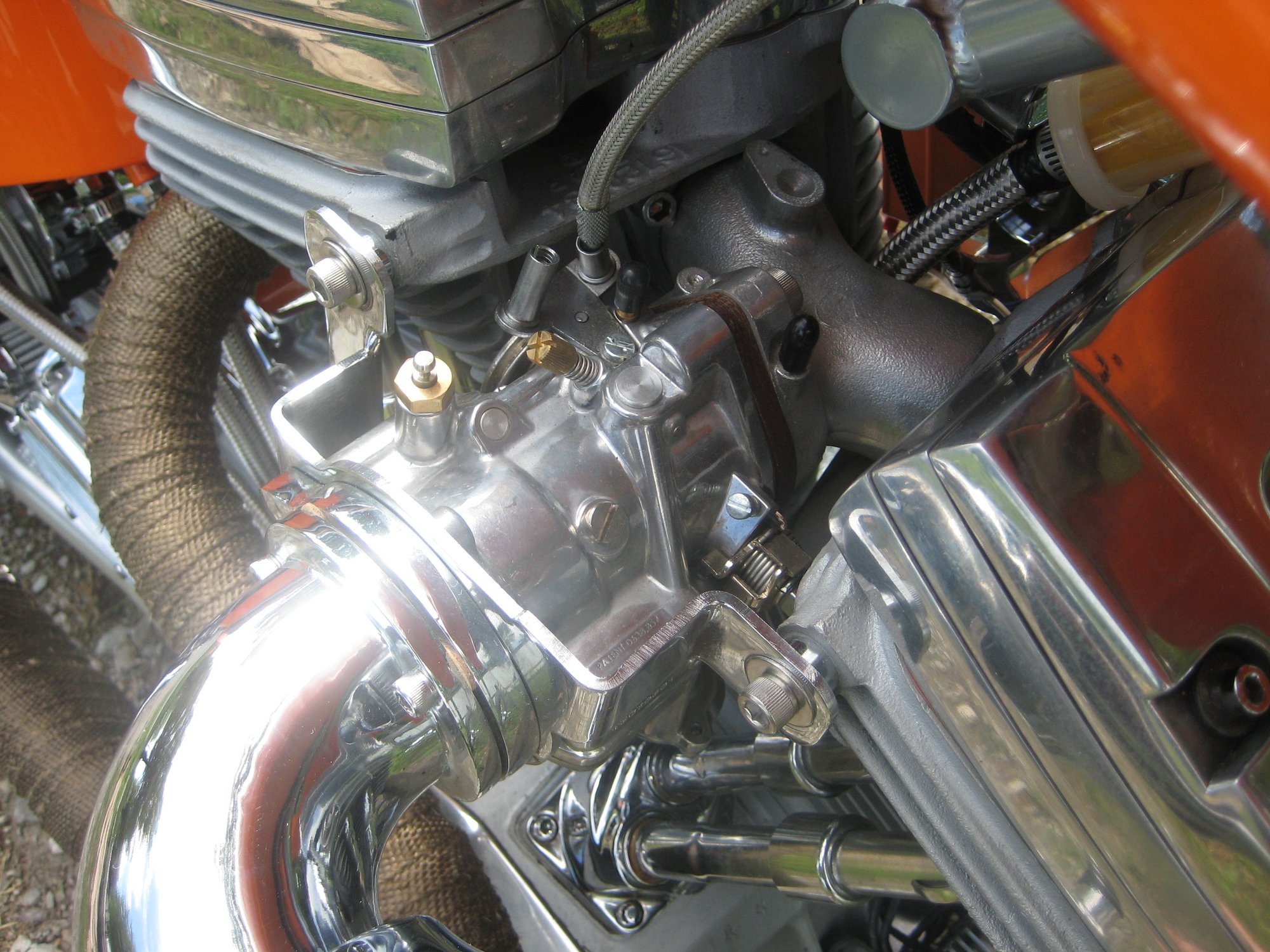

D_gyver's Avatar
D_gyver
Joined: Feb 2014
Posts: 913
Likes: 5
From: indiana
here is a pic of how mine is done
Old Jul 1, 2014 | 03:54 PM
aces&8s's Avatar
aces&8s
Posts: 6,570
Likes: 590
From: almost there
Mr D, how does those heads breath, or is that a bottom breather?
