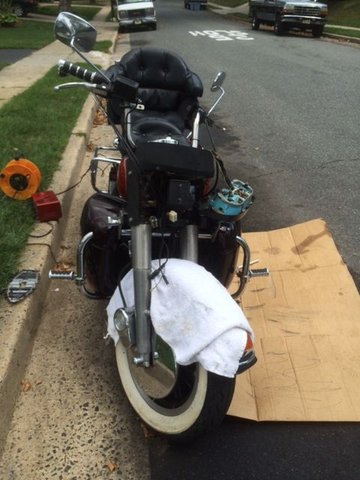

I finally got some time to remove my fairing and repair a bad wire. It was a easy find (the main power to the breakers) so with soldering gun in hand made the repair. While in there I put a 2nd solenoid for the headlight. I also added more grounds the soldering gun and wire was already out so it couldn't hurt. What a difference, my volt meter on the fairing is showing 14 volts before it showed 10 and the oil pressure gauge is also working. Put it all back together and put 400 miles on her. Its great to have a dependable bike again!!! My next project is the headlights. Does anyone know what I can do to swap out the h4671 bulbs for a brighter whiter light? I like to ride at night and those yellows are just not bright enough for me. My bike is a 90 fltcu. Thanks for all the advice.

Yeah, get the Truck Lite LED headlight. See the other thread here discussing it now.
Bonus points for fixing it in the street.
