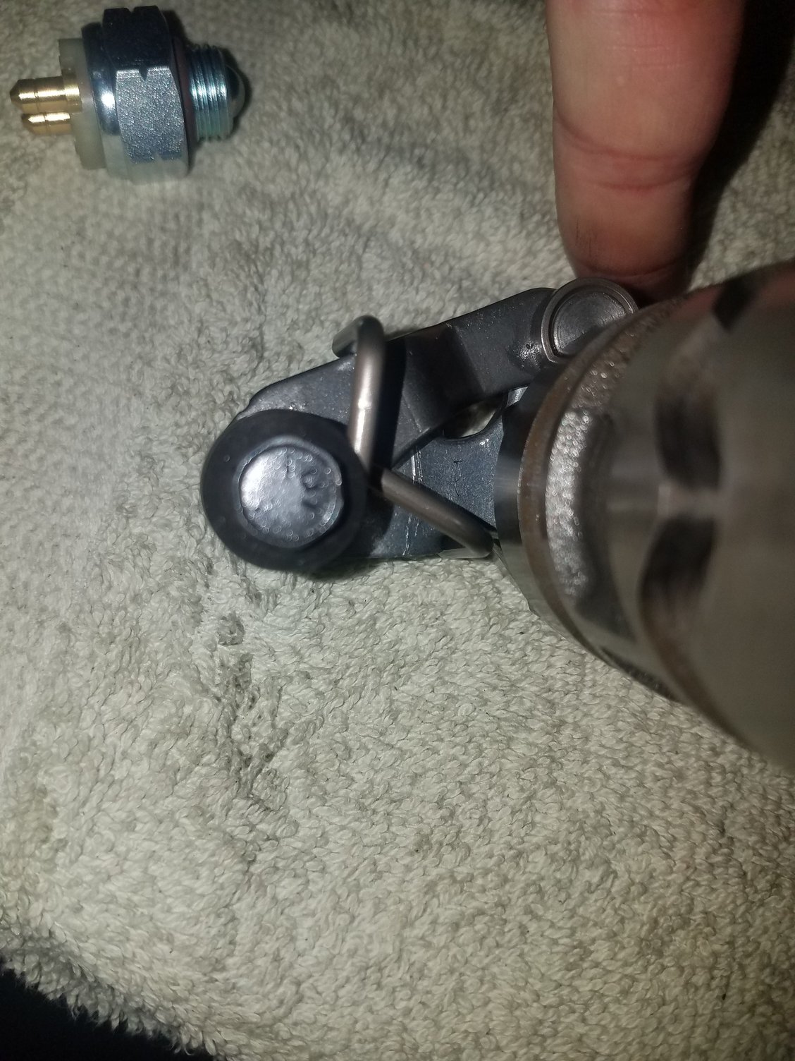

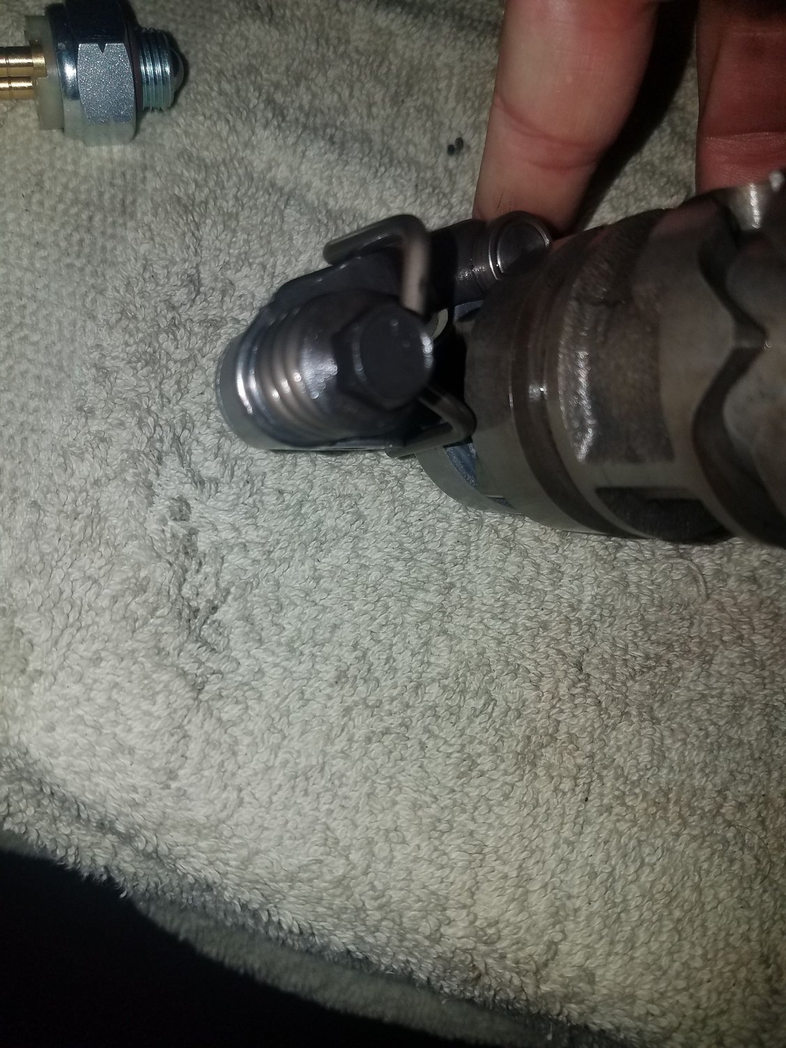

So... here's what I've been doing with my 1998 Road Glide with 140,000 miles.
Updated to a 2000-2005 Twinkie 5 speed gearset that I found on Ebay dirt cheap and looks brand new, what a score!
I replaced every single bearings that were on the case and seals.
Updated the Twin cam shift drum to a Baker version and also purchased their upgraded shift pawl and link.
it is a great upgrade to say the least. The Trap door bearings are significantly larger than the ones on my 1998 (Evo) and the shafts are bigger also.
I thoroughly measured everything and it is a direct form, fit & function replacement.
I also had to purchase a newer neutral safety switch.
I can't believe the difference between the Evo and Twin Cam trap door bearings.
In addition if you don't purchase the Baker upgraded shifter drum and Shift pawl you're taking a chance of the OEM HD (Twin Cam) breaking.
The shift drum from the twin cam has a detent and spring with a lot of tension on it the only thing holding that spring together is a shouldered 1/4-20 screw.
Baker makes it much beefier than HD, if the HD 1/4-20 bolt breaks off its going directly into the gearbox (not pretty).
On the one I purchased it appears that the shouldered bolt is already showing signs of stress and sagging.
Ain't no way in the world I'd be installing that thing into my bike!
Are you saying the Twin Cam shift drum came with the straight slot screw holding the spring (they did not), or is that the Baker shift drum, your description is hard to follow because you interchange the words screw and bolt..?
The shafts are not bigger.
The mainshafts are the same part numbers, from 1991 to 2006.
Countershafts are the same part number for all 5 speeds.
The `99 and later trap door bearings have a larger outside diameter, but the inside diameter did not change.

Yes, the trap door bearings are significantly larger than those of my 1998 Evo.
The Twin Cam shift drum looks mulched improved upon however, there is a very big spring which is held in place by a smaller shouldered bolt.
The Baker one doesn't rely upon any such bolt and looks a lot stronger than the HD version.
Sorry for the crappy photos. It's hard to capture what I'm saying but given the choice I'd say the Baker version is significantly better.
The shift Pawl that I ordered is similar to the HD one but only different in one small part.

I have never seen or heard of a failure of the OEM shift drum...

Which one is the baker in the pic?
it's the one that has the shiny black shift drum and slotted area where the spring passes through it.
