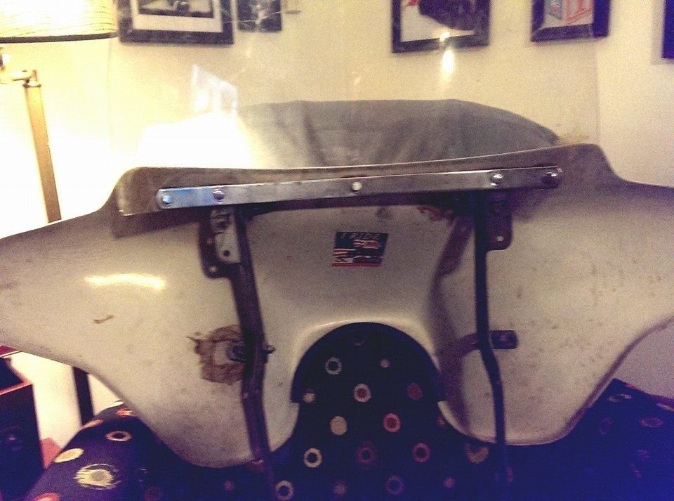

Found this on CL. Said it came off of an old FLH shovelhead. Looks in pretty decent shape. What do you think? Should fit my 89 FLHS, right? Maybe minor mods?
I think one if the British chaps gbbrown is running a shovelhead batwing but for 80 bucks It worth a shot

I cannot lie! Had one on my 1990 FLHS for most of it's life.
I actually made up new mounting brackets for mine (well, my metalworking brother did!) as the original mounts wouldn't work very well and with his skills it was easier to start from scratch. The FLHS headlamp nacelle is bulkier than the older FLH one and set higher up the bike, so while the batwing will snug up to it nicely, the studs on the back of it were a long way away from where they were supposed to fit on the main mounts. It also has to be juggled to fit around the spot-lamps and I set it up to lie back rather more than stock.
Yours looks fine and with a lick of paint.....

I put an aftermarket batwing on my wife's sporty and I had to fabricate my own hardware. It was pretty easy. I bought everything I needed at the local hardware store. If you can cut, grind, drill and bend you can make some slick mounts. I also mounted a 300 watt stereo in there. You can hear her coming a mile away..

I am a better than average shade tree mechanic, so it's great to hear this is a case of using some ingenuity and some common sense.
