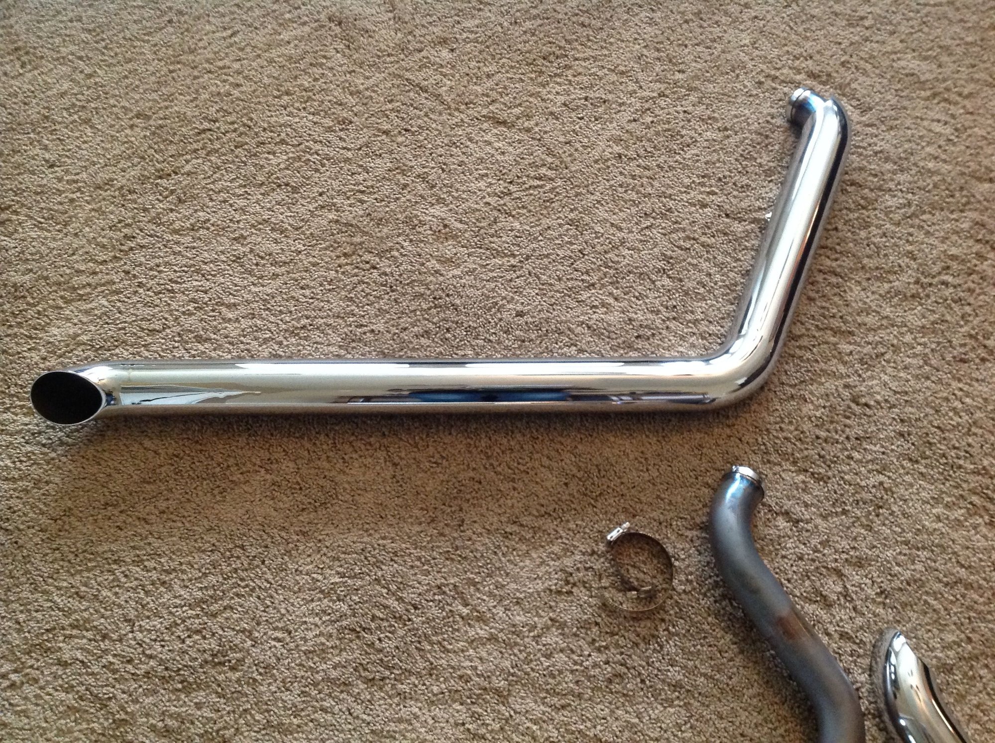

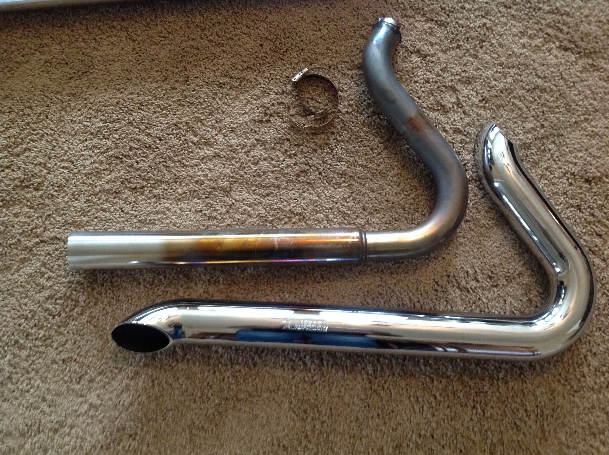

Old Mar 12, 2017 | 03:27 PM
Hession's Avatar
Hession
Joined: Aug 2015
Posts: 80
Likes: 10
From: Houston
Ok, you got me curious so I went and pulled them out
Old Mar 12, 2017 | 04:12 PM
25-06's Avatar
25-06
Posts: 86
Likes: 5

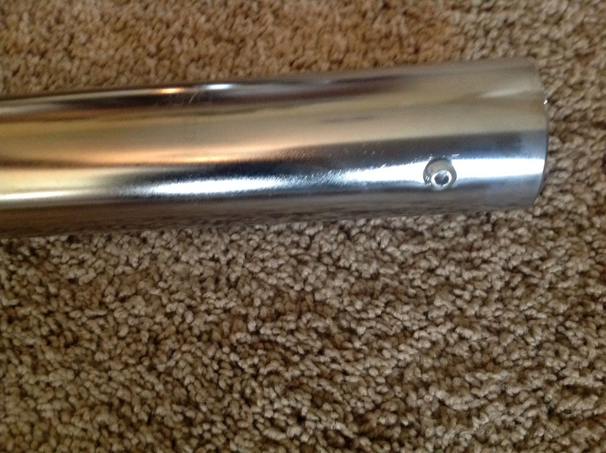

Wow! Thanks for your efforts! I guess that explains it, doesn't it? I just haven't been paying enough attention to details, because I had NO idea that anyone was making heat shields that long. Craziness, but very cool! I seriously thought they were just one single pipe with a small heat shield up nearest the flange. Shows you what I know! ;-)
Anywho, the one header and heat shield that you've photographed here looks pretty clean in terms of chrome finish, etc., so I suspect the other one does too, and I can't really tell from the photo(s) if they have the proper O2 sensor bungs (?), but are you saying that you're looking to part with these?

Old Mar 12, 2017 | 05:04 PM
Hession's Avatar
Hession
Joined: Aug 2015
Posts: 80
Likes: 10
From: Houston
Yeah no kidding, surprised me a bit when I unwrapped everything on how they achieve the turnout look. Shoot me a pm with email and we can work something out - I need to go rummage thru and find the mounting plate for them.
