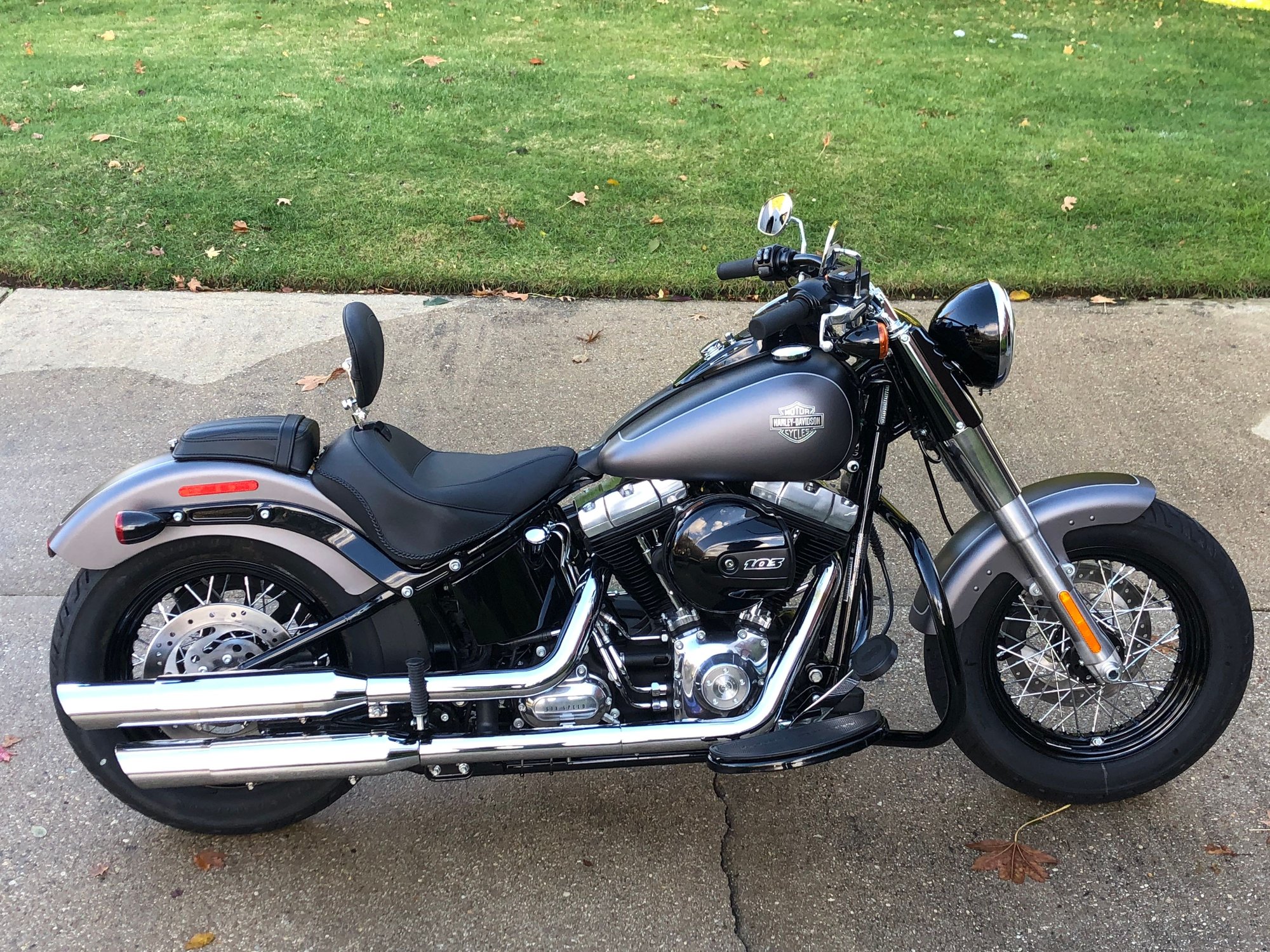

Actually they do. The gasket goes between the exit end of the head pipe and the inlet end of the muffler. Here's a picture of my slip ons with gaskets installed. Without these you will have some serious exhaust leaks. Some after market slip ons do not need these. Sounds like yours need these.
