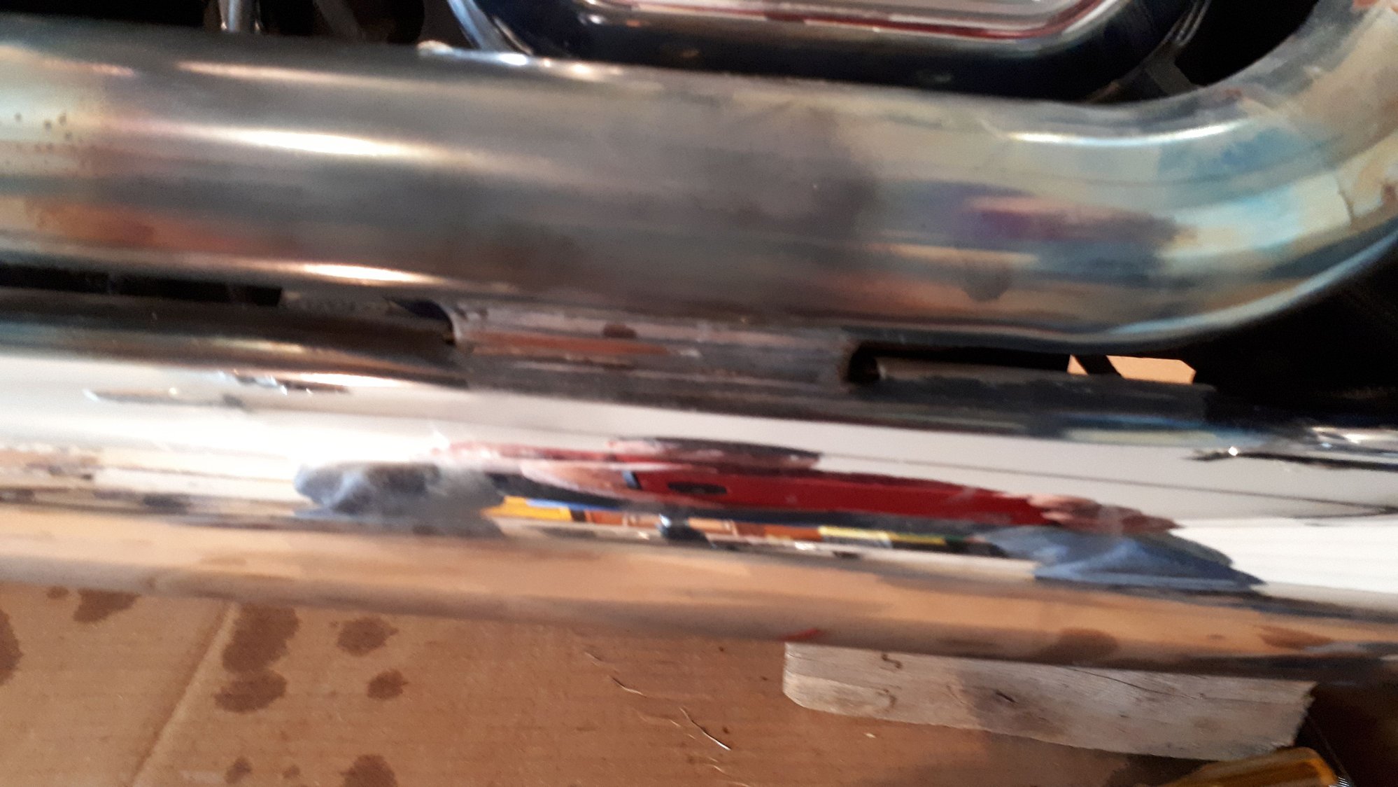

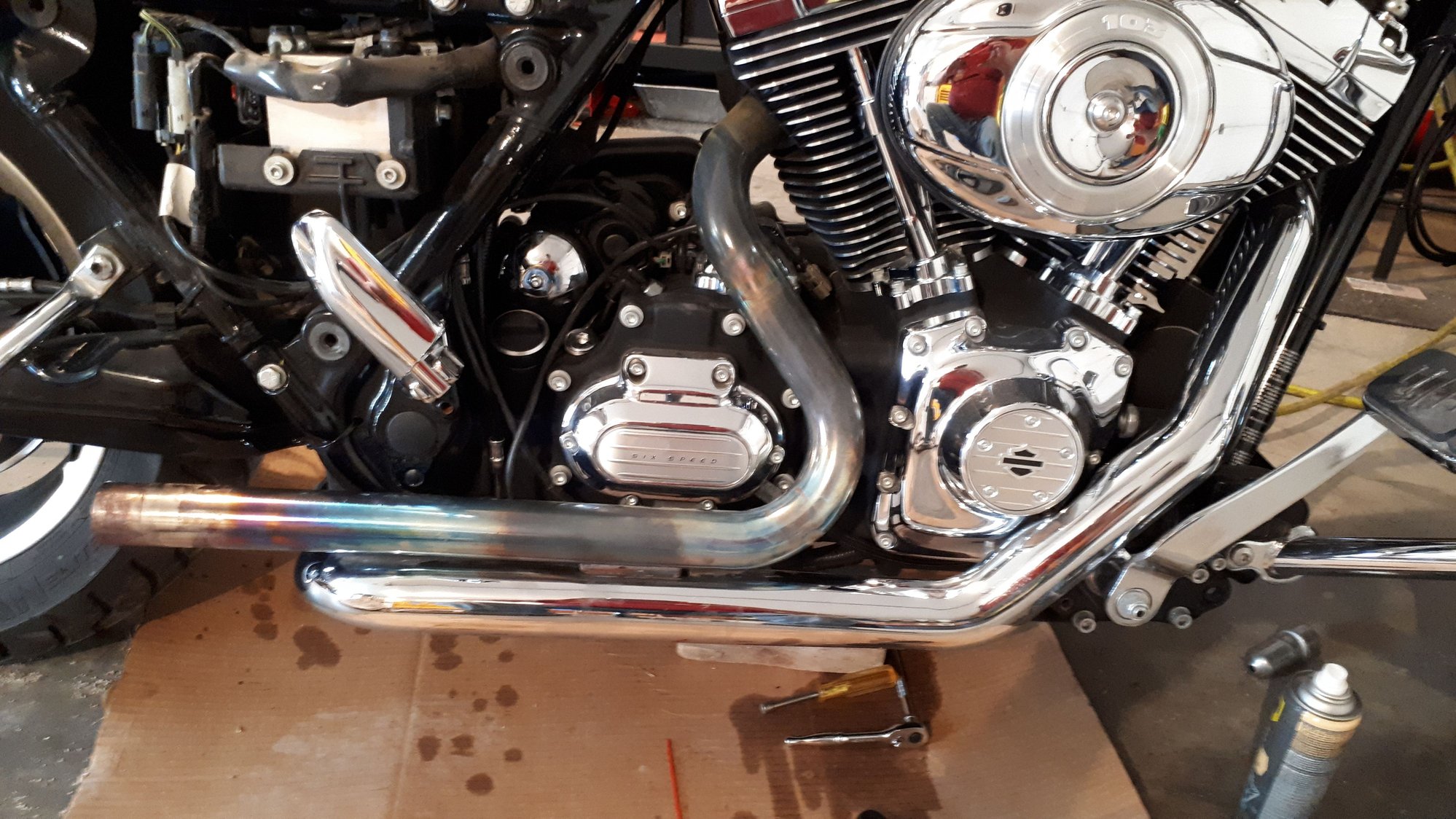

Howdy
Help.
Separate head-pipes to mufflers with rectangular crossover between pipes. Didn't realize this until I got one of the heat shields off.
Doesn't look like Cobra. Anybody have any ideas who makes it.
Was going to put a Cobra on but no reason now.
wADE

Old May 20, 2019 | 07:52 PM
Petriw's Avatar
Petriw
5th Gear
Joined: May 2015
Posts: 9
From: Saskatoon, Canada
Default Photos Headpipe 2012 FLHX
Originally Posted by OldEnuf2NoBtr
Uh, how about a picture?

S&S makes one...I had one but never installed it

Looks like it could be an S&S Power Tune header, if it is not a Cobra Powerport. I have the Cobra on my bike, and have a used S&S one on a shelf in my garage. Not much difference in appearance, but the crossover port is a little more forward on the S&S I think.
S&S: https://www.fuelmotousa.com/series-2...%20KING%20FLHR
Cobra: https://www.fuelmotousa.com/series-1...%20KING%20FLHR

That's them. Thanks so very much

That's an identical match to mine. Those are S&S for sure?

S&S or Khrome Werks, they are the same pipe to an extent... Khrome Werks made the S&S pipe for them before S&S started doing them in-house a couple years ago. We have found the S&S pipes have far more issues coming out of the box than when KW was making them. Bad welds, poor fitment, poor finish seem to be way more common, so with that knowledge we order the KW version, FWIW.
