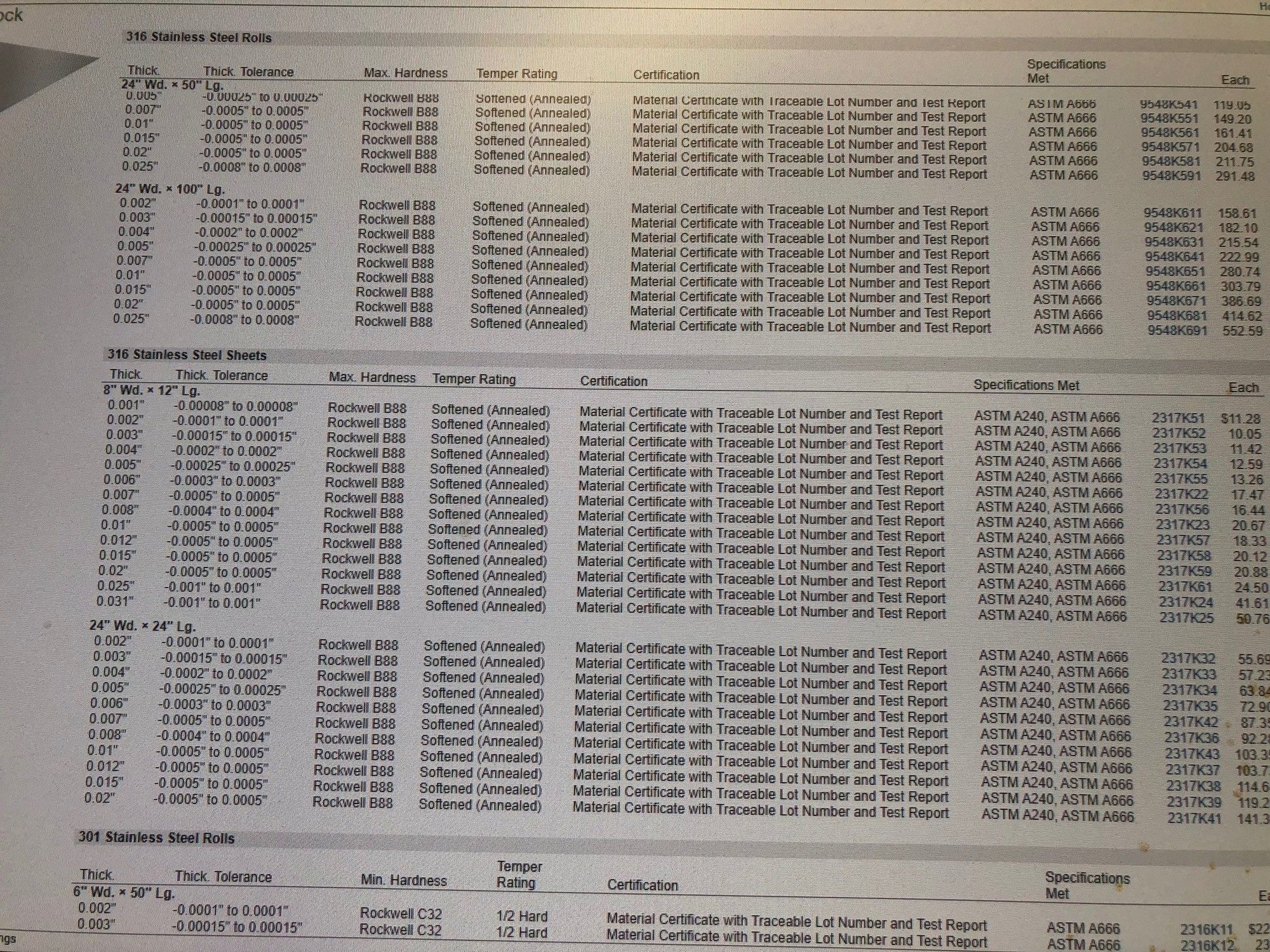

Shim stock as shown below could be a PITA to install
