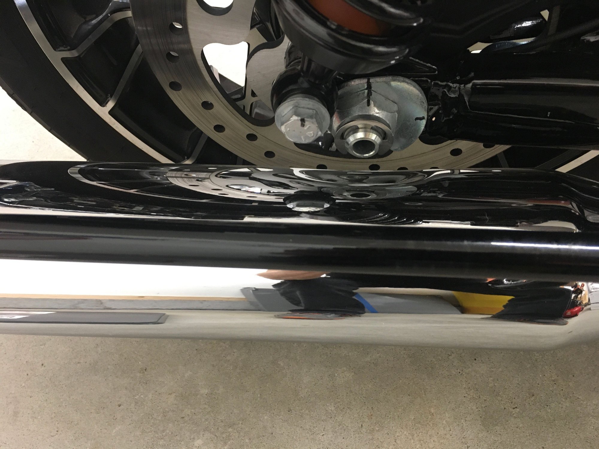

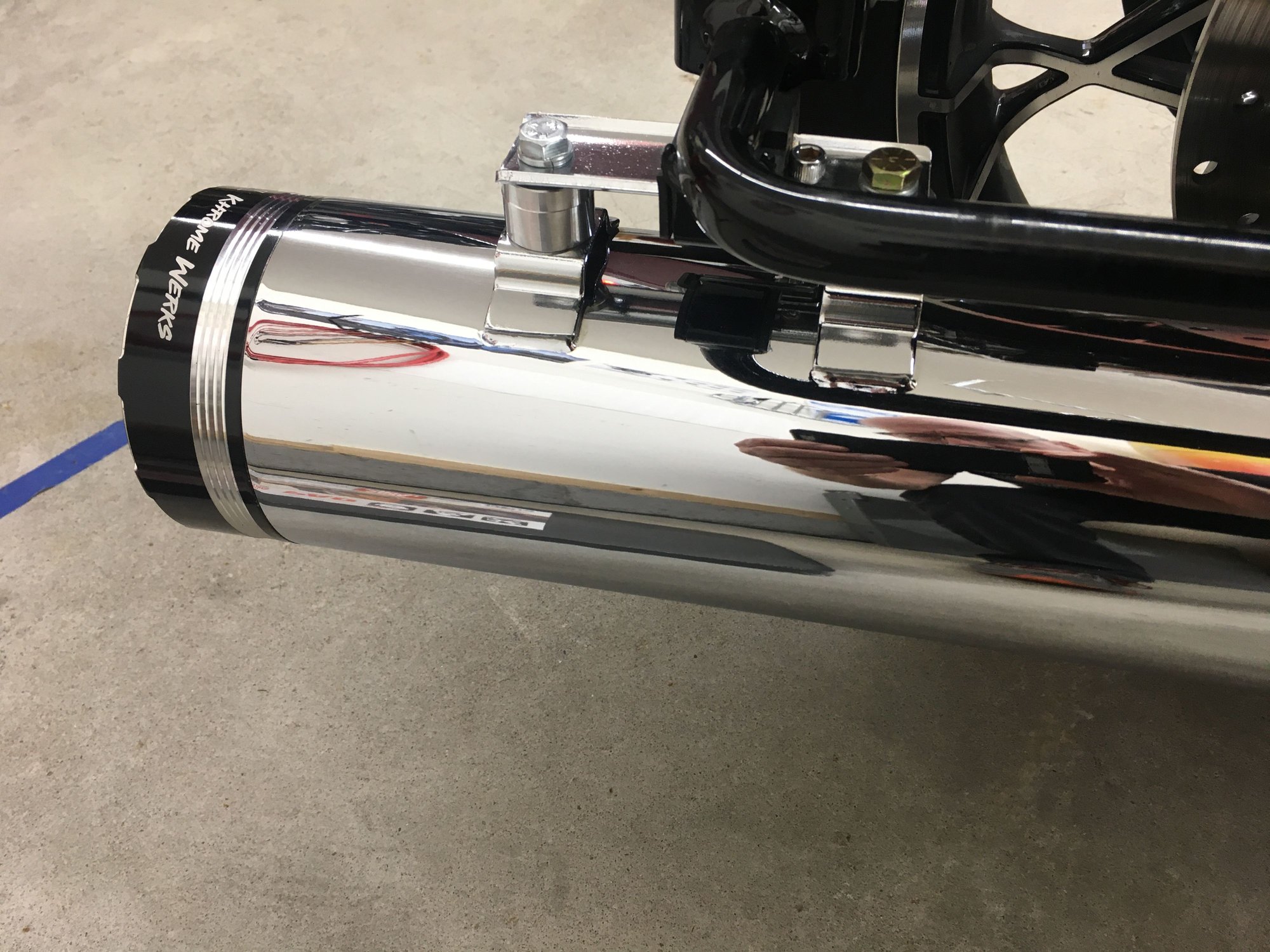

Second, following the instructions to the letter, there is zero way to get the muffler on. While there is a dimple for the axle nut area, it's ONLY at the axle nut area, and there is no friggin way this muffler is going on without beating it with a sledge and ruining the back of the muffler as well as gouging out the top with the axle nut and axle.
It's been a very discouraging day. I had hoped for better results, however the local shop I purchased the exhaust from is closed until Tuesday, Khromewerks is closed until Monday, and I have no way to proceed. Can't setup the Thundermax without the Wideband sensors. So, it appears as though Khromewerks has cost me at least a week, since I'm tied up next weekend - so probably two weeks.
Anybody install this setup on a '14 Ultra? I'm curious if I just have some quality issues with what I got in addition to the missing heat shield, or if there is some magical process. I did lightly lube the inside of the muffler inlet and the outside of the collector hoping that would maybe provide some relief, but nope.

thanks. However that doesn’t solve the interference issue. The muffler is FAR too close to the axle assembly. I’ve also installed tons of 2-1 exhaust systems. Fatcat, road rage, etc. And far more on my race bikes. Never had so many issues as on this one before. I have a call into khromewerks. Not proceeding now until I talk to them as I’m convinced the muffler will get gouged all to hell. There’s not even enough room for a t shirt between the muffler and the axle nut. I thought about pulling the axle but don’t want to get in a situation where the axle needs to come out to remove an exhaust.

Plenty of room on mine. I also spaced the muffler down a bit so the pipe has a level appearance. Still plenty of room w/o spacing. Did you install the supplied clamp mount to the lower transmission?

Mine has nowhere near that much room. And yes, I installed their P-Clamp mount to the lower transmission.

just for accuracy khromewerks does NOT say to have the full system together and then tighten from front to rear. I can upload the instructions if necessary. Their instructions explicitly state to install headers with front and rear exhaust flange nuts loose then p bracket at tranny cover loose then torque flange nuts and then p bracket. THEN install muffler with clamp.
however even then the root issue isn’t addressed. Assuming I did it the way you suggest I do not believe that changes the root issue of interference.
I’ve called them and left a msg on Saturday but will call them today. We will see. I’m suspicious as I forgot to mention they supplied two different p brackets with different designs- though it’s not mentioned anywhere in parts list, instructions, etc. yes I tried both. Between this, the fact that I was shorted the collector heat shield, the clear interference, my concern is high.
