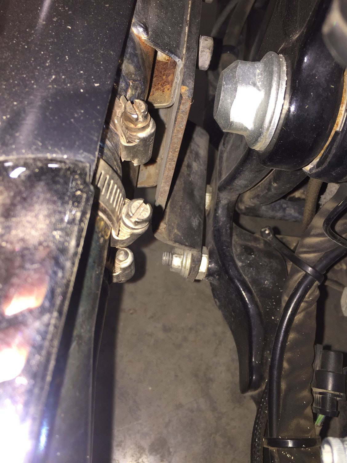

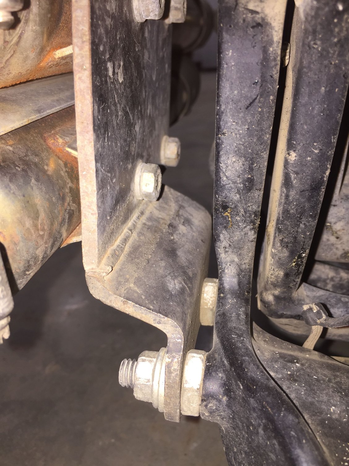

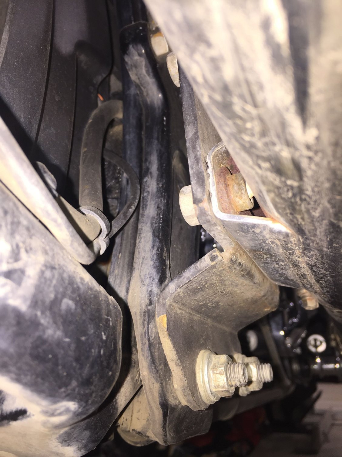

idk if you can see much in the pics, but I had to cut the bracket apart, then reweld it. Matched it up to the stock mounting location.
i also added a rubber covered conduit clap to the oil line to keep it from rubbing.

Awesome pictures, thanks! Is it possible to mount it without welding a new piece?

It might be, if you make a new bracket. I really don't remember. I know it worked very nice this way, but don't remember how the bracket was to start with.

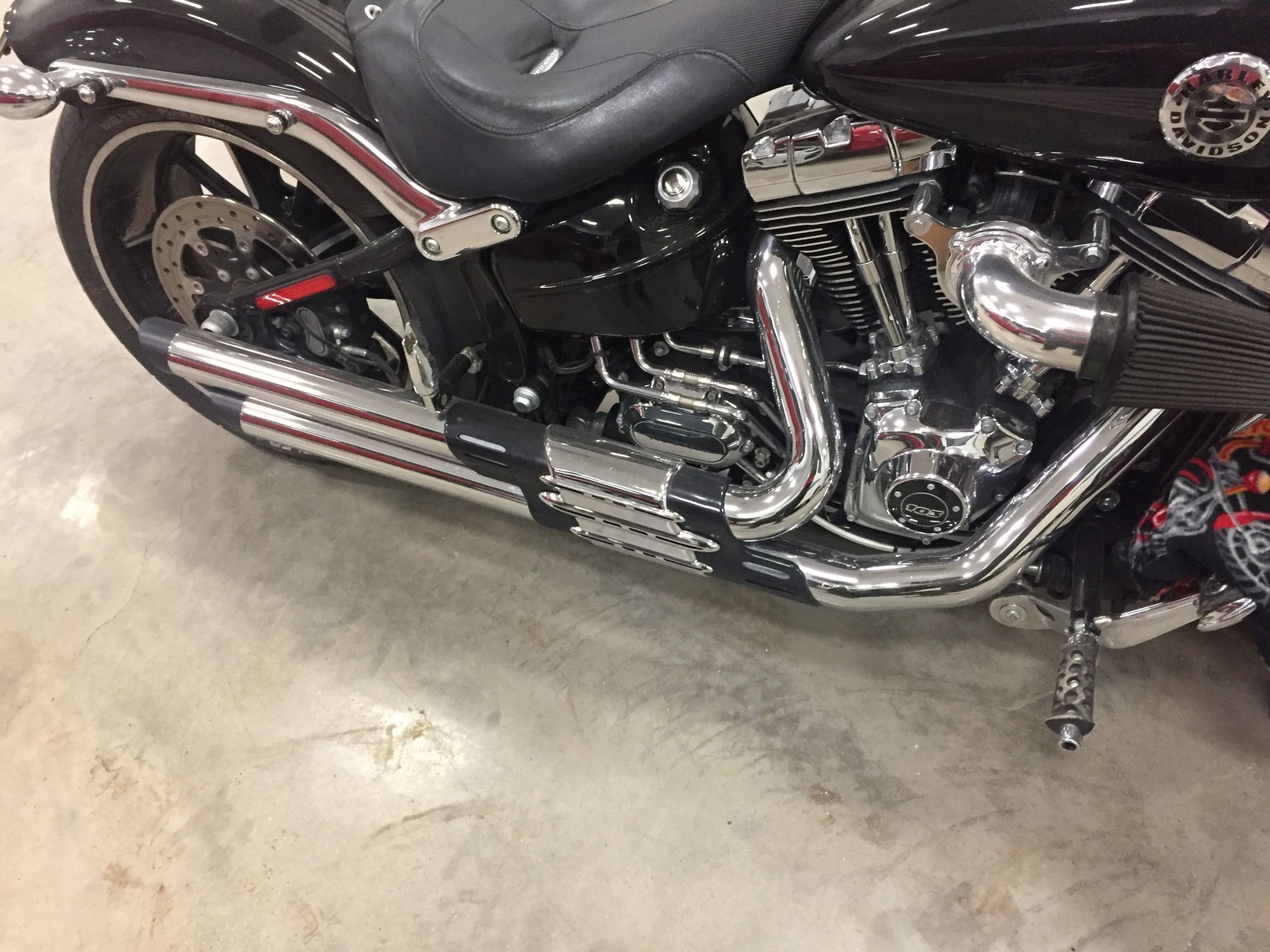

I'm so glad I rolled the dice on this! It looks awesome, and sounds amazing!
Thank you JamieDTR! I was able to use the original bracket, I just removed the existing mounting screws and used theirs. That got rid of the alignment issues.
It fits almost perfect. I had to leave everything loose and tighten it up with constant adjustments.
