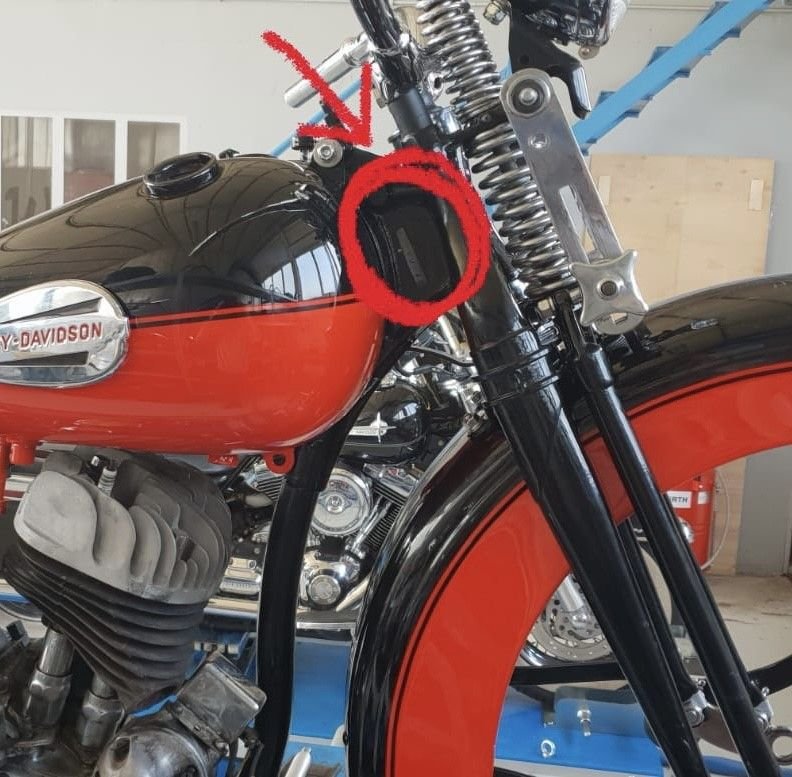

I have the old documents of registration. No engine # was shown. There was only the frame # 114654 that is stamped (probably from Italian authorities since from what I've understood no frame # was stamped by HD at that time) in the position showed in the picture.
First registration in Italy is reported to be in 1952 but at those times the data were not "very accurate".
In Italy this R circled has no mean and authorities do not have a clue of what it is.
I'm not quite sure where to find the markings on the steering head. Can you please be more clear (a picture will help)?
Tomorrow I'll go to the mechanic where the bike is so I can eventually make pictures of the marks.

Yes, that frame number is NOT factory, added the same time the VIN was put on the motor. I would take that to my local DMV and see what they want me to do. Now I nothing about Italian DMV, but you basically have proof of ownership with a verifiable number. It is going to be to them to make a decision how to proceed.

As you suggested the frame number may be from Italian authorities. But without an engine number on that document I couldn’t say if that engine was in that frame when the bike was first registered in 1952 and I couldn’t say if that engine was in that frame when that document was signed in 1964. And we still don’t know for certain who stamped 6175 and the Rs or when any of those markings were applied to the engine. Has the former owner got any more info on the history of the bike?
For markings on the steering head please look on the opposite side to where your frame number is.

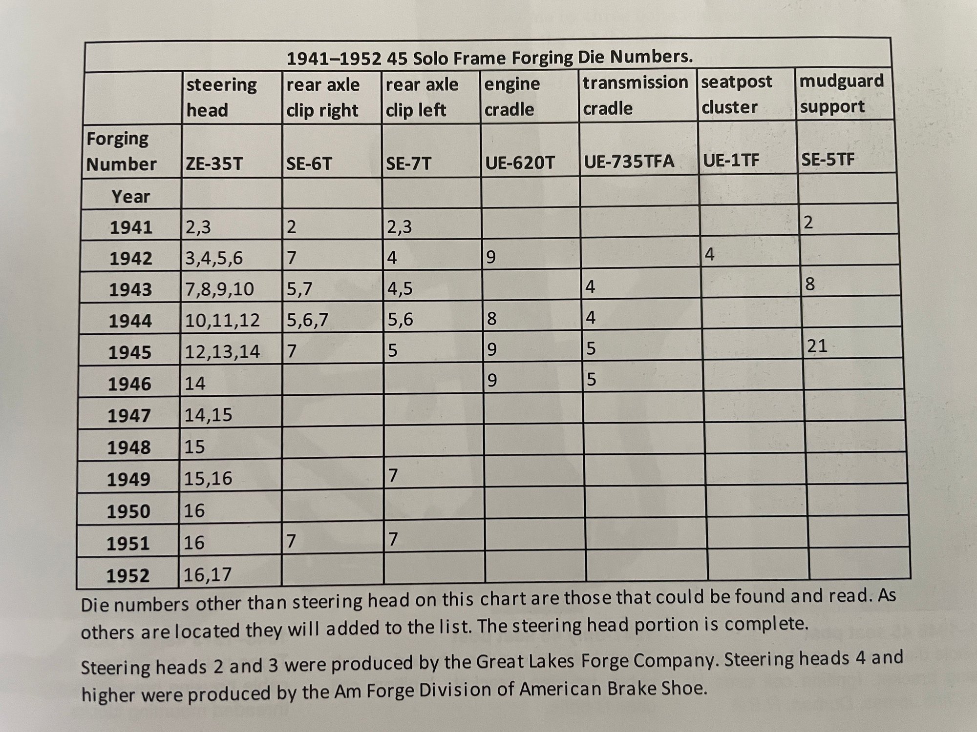

Not all die number will be in his charts for a variety of reasons so you have to use your judgement. One of my axle clips on my 48 has a die number that falls into a gap in Palmers numbers. In your case looking at the die number range for the left clip I would guess yours is in the 41 or 42 model year. Check out the other die numbers on your frame and compare to the chart, that will narrow down the year.
