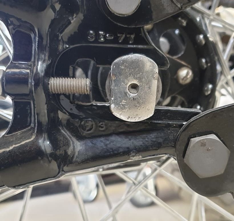

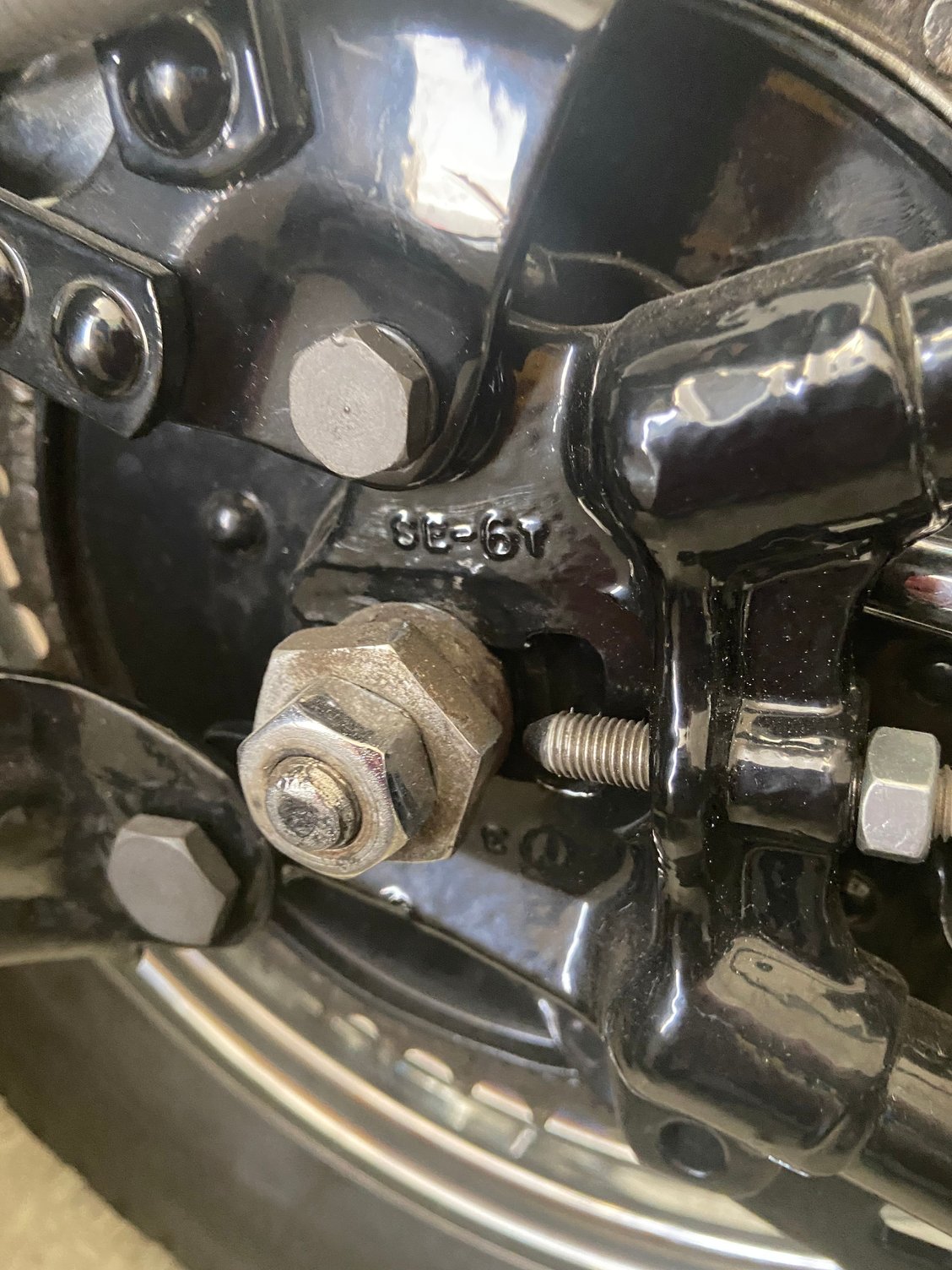

Originally Posted by Gian15
Hi here the marking on axle clip. What are they telling?
no markings on the top of the frame.
Thks
Gian
On the R-H axle clip, forging number SE-6T is correct although it was introduced before 1941. Forging die number 3 apparently indicates 1941–42. The forging hallmark isn’t Y but is instead M over F inside a circle which represents Modern Drop Forge, the maker of that axle clip.
Outside the left axle clip you may find forging number SE-7T, hallmark M over F and a die number. What is the die number? Photo?

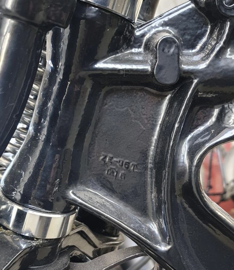

What markings are on the left side of the steering head? Photo?
Eric

Hi Eric,
LH axle clip shows SE-7T and a number 3
Steering head report ZE-35T (36T?...to the mechanic where the bike is it appears a 36T)... I'm 60 miles from him and he's not "able" to get a better picture. To me it seems a 35T
Have a nice one.
Gian

Need to get a better pic of the neck number. Yes its a 35T but the number beside the "A in a jar" narrows down the year. Guessing, it looks like a 6 but that doesn't jive so much with the axle clips being a 3. Get a better angle of that area.

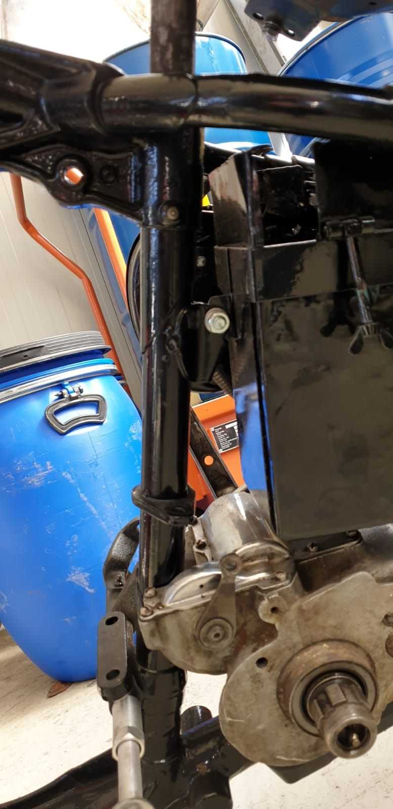

Thanks for the photos. Steering head forging number is probably ZE-35T (not 36T). Forging hallmark which looks like A in a jar represents AmForge. Hard to be certain about the die number but I agree it could be 6 which was one of at least four die numbers used for 1942.
Left clip forging number SE-7T is correct. Below the axle is hallmark M over F inside a circle. Die number 3 was used for at least 1941 so maybe it was also used for 1942?
And remember your R-H clip also has die number 3 which apparently indicates 1941–42.
At this stage the combination of the axle clips and steering head suggest to me that your frame may be a 1942 model.
Can you post a photo of this section please. Thanks.
Getting back to that document, it was signed in 1964 and it indicates the bike was first registered in 1952. But in 1952, what model year was the bike registered as? Was it registered as a 1952 model or some other year?
Eric
Eric
Hi here below the picture.
I do not have the old papers (besides the one from 1964 already posted) . At that time no model year was indicated at all the only info was the date of first registration of the Italian circulation permission that was from 1952.
In one formal document it was written that the Harley was made in England… this is telling you how knowledgeable they were at those times… 😁

In your photo the clutch cable tube bracket is the type I’d expect. It is the two-hole style used for 1941–46.
Also notice two unmachined bosses and these were apparently omitted as of 1949 or 1950 models.
Eric
