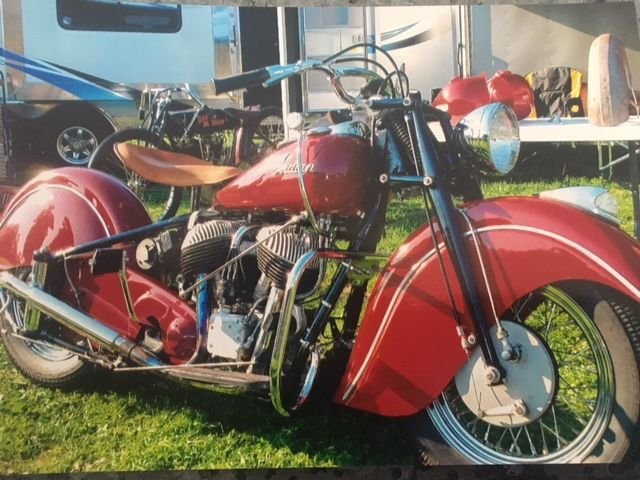

apples to apples - they were from the same mind set in engineering yea different but very much on the same ideas - i prefer the Indian in every way as i have owned everything and ridden everything being around this since in was a kid and push home a 1920s Indian scout in my early teens - no never got it to run and my wonderful mother push it out to the street while i was at school one day about a year later - today i only own around 10 bikes maybe more my 1948 Indian chief my favorite of all time

John, your Indian is gorgeous, it looks like a two wheeled voluptuous women, very nice.
