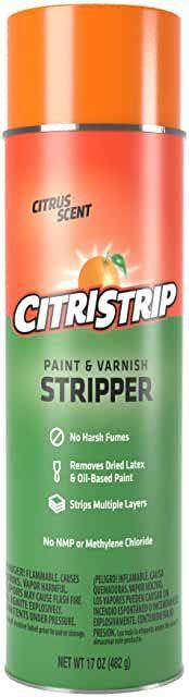

Ok we use this first it works well and saves time on beading if your beading it your self - then or first we tape off the top and bottom of the piston cylinder and grease the top and bottom only about 2 inches is needed if you do 3 thats fine

Its hard to find a good stripper these days because of government restrictions. I'll have to try John's recommendation.
