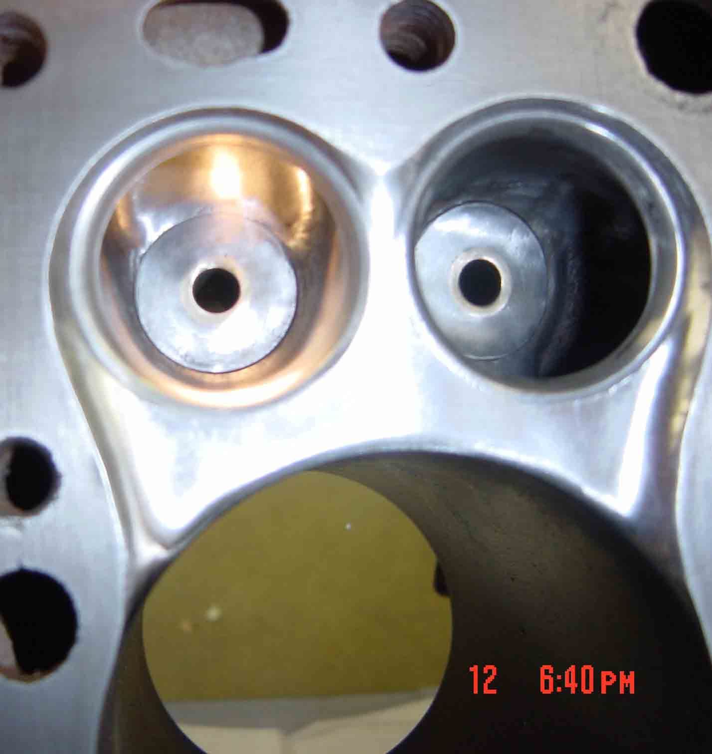

Do this or something less extreme. Its not just Harley specific but Harley did relieve the 80" decks from the factory but not the 74". Of course it will affect your compression ratio. Another reason to know what you have right now before you go killing the ratio to get flow.

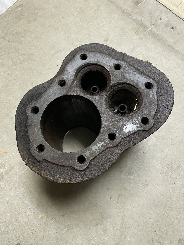

Here's my stock 80 barrel thats relieved from the factory.
Paul, that’s good info and the pictures really help, I’ll be out in the shop later farting around and I’m going to CC the heads so I can calculate C/R.
