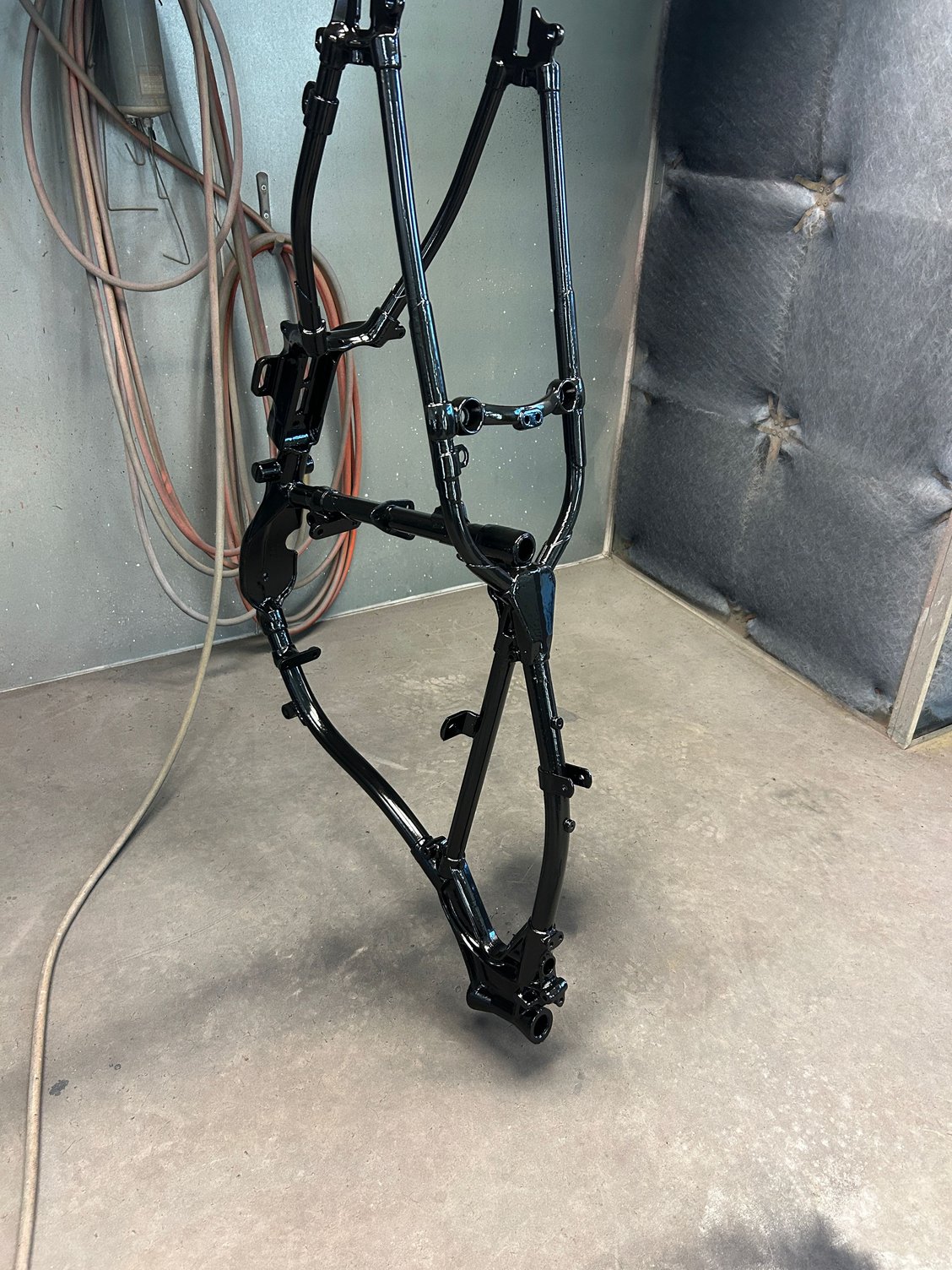

Well ,
Have them bead blasted  ready to prime epoxy
epoxying the frame
epoxying the frame

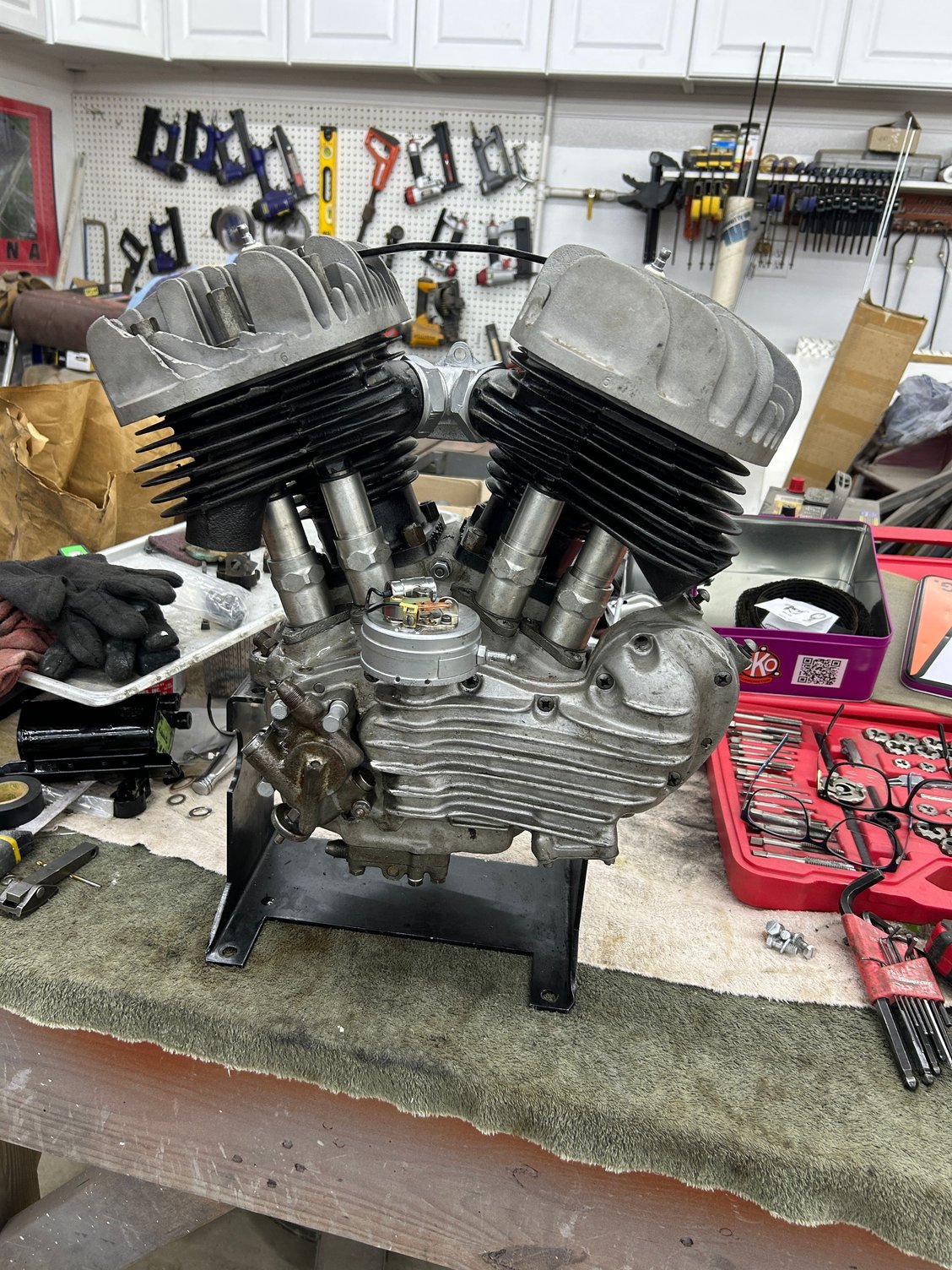

The start of the  wl engine

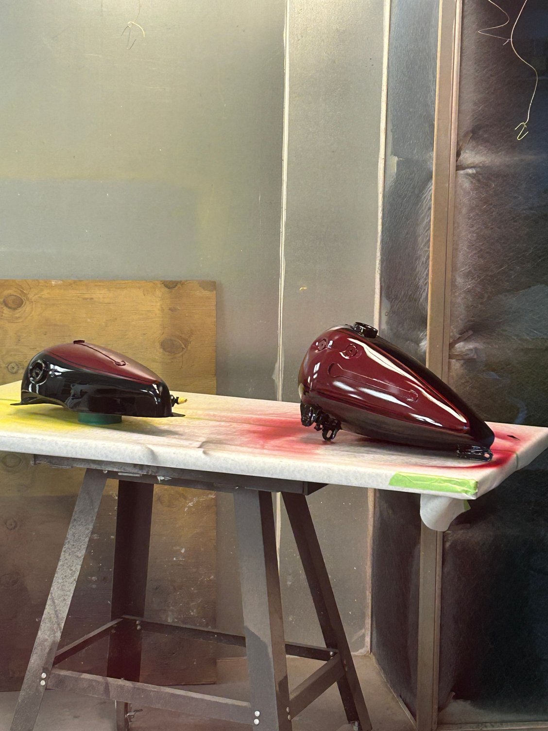

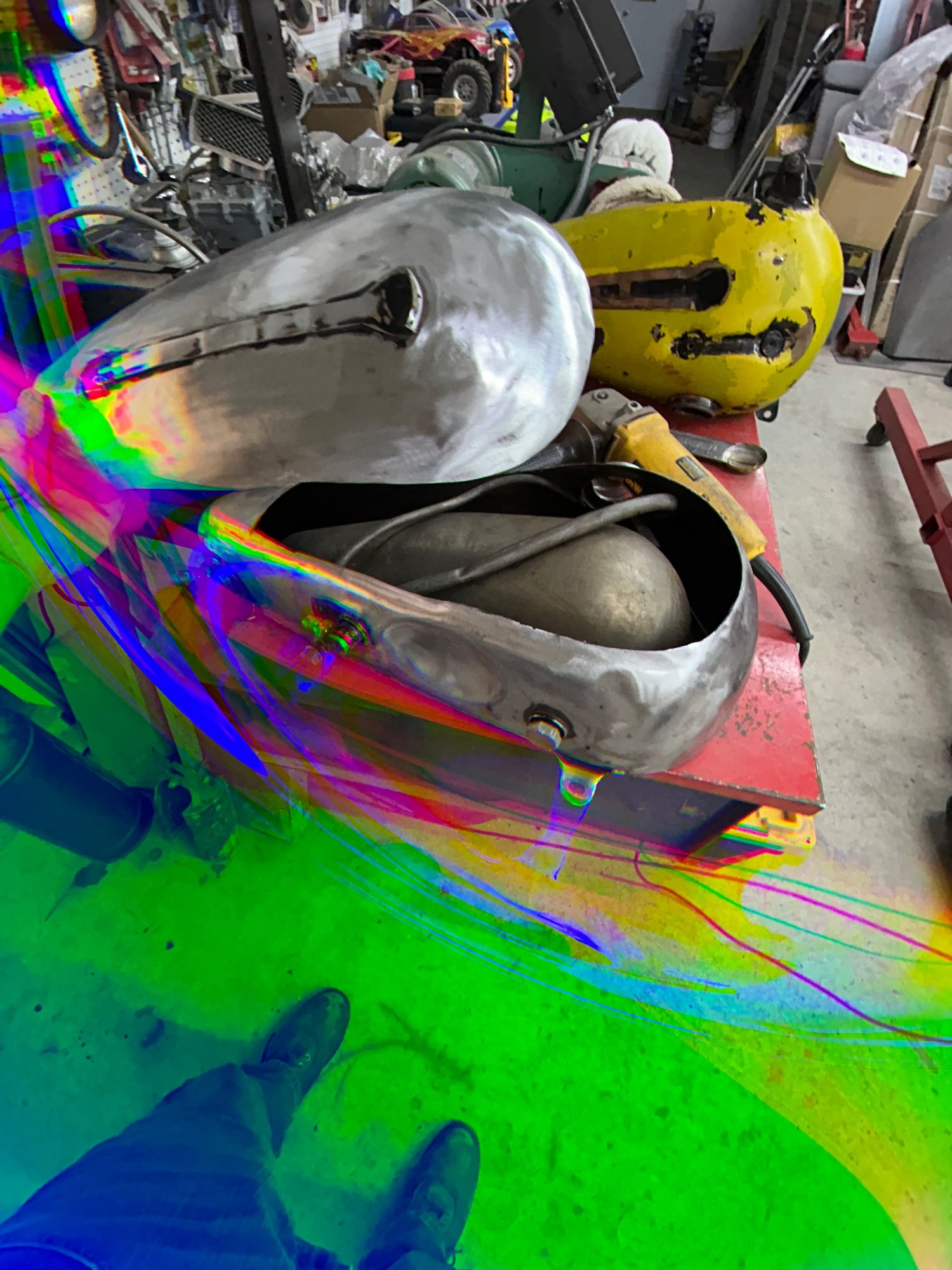

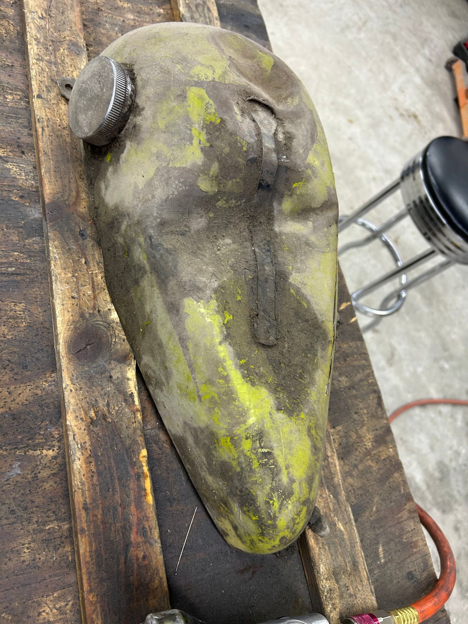

Got the tanks all welded up and dents out and epoxy on the parts

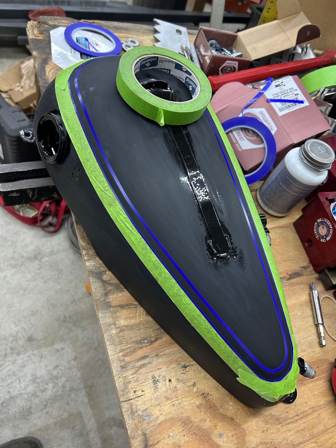

Masking off the tanks for the insert color
ready to clear
ready to clear

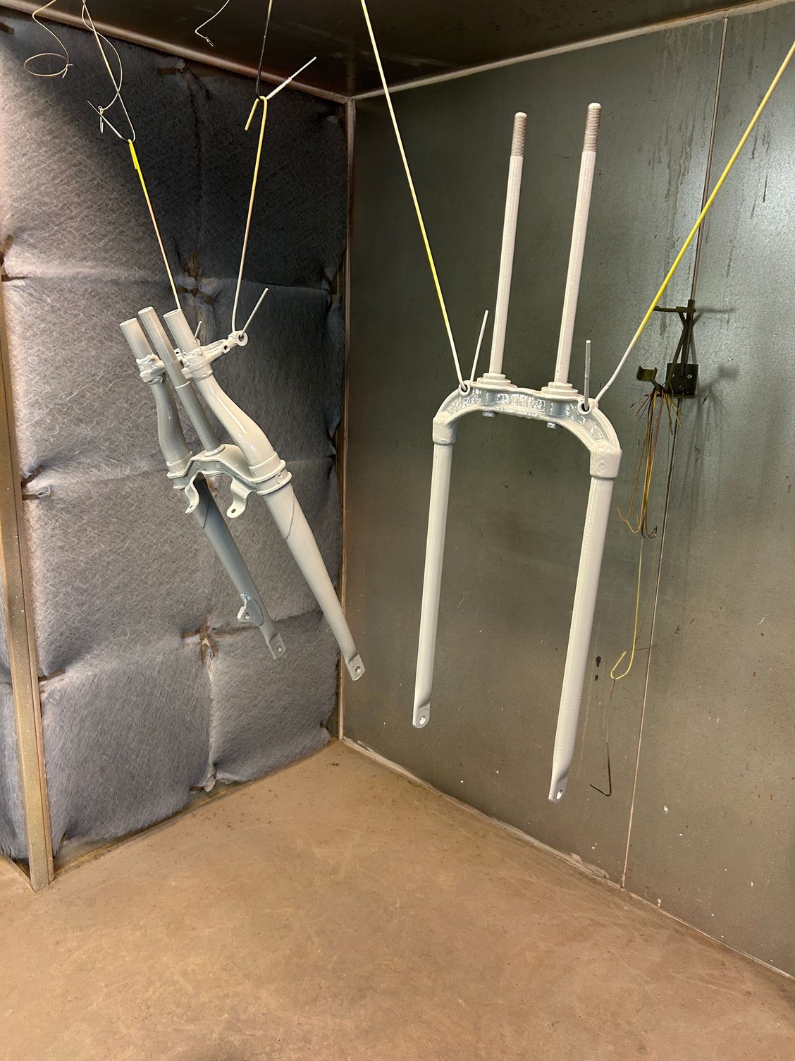

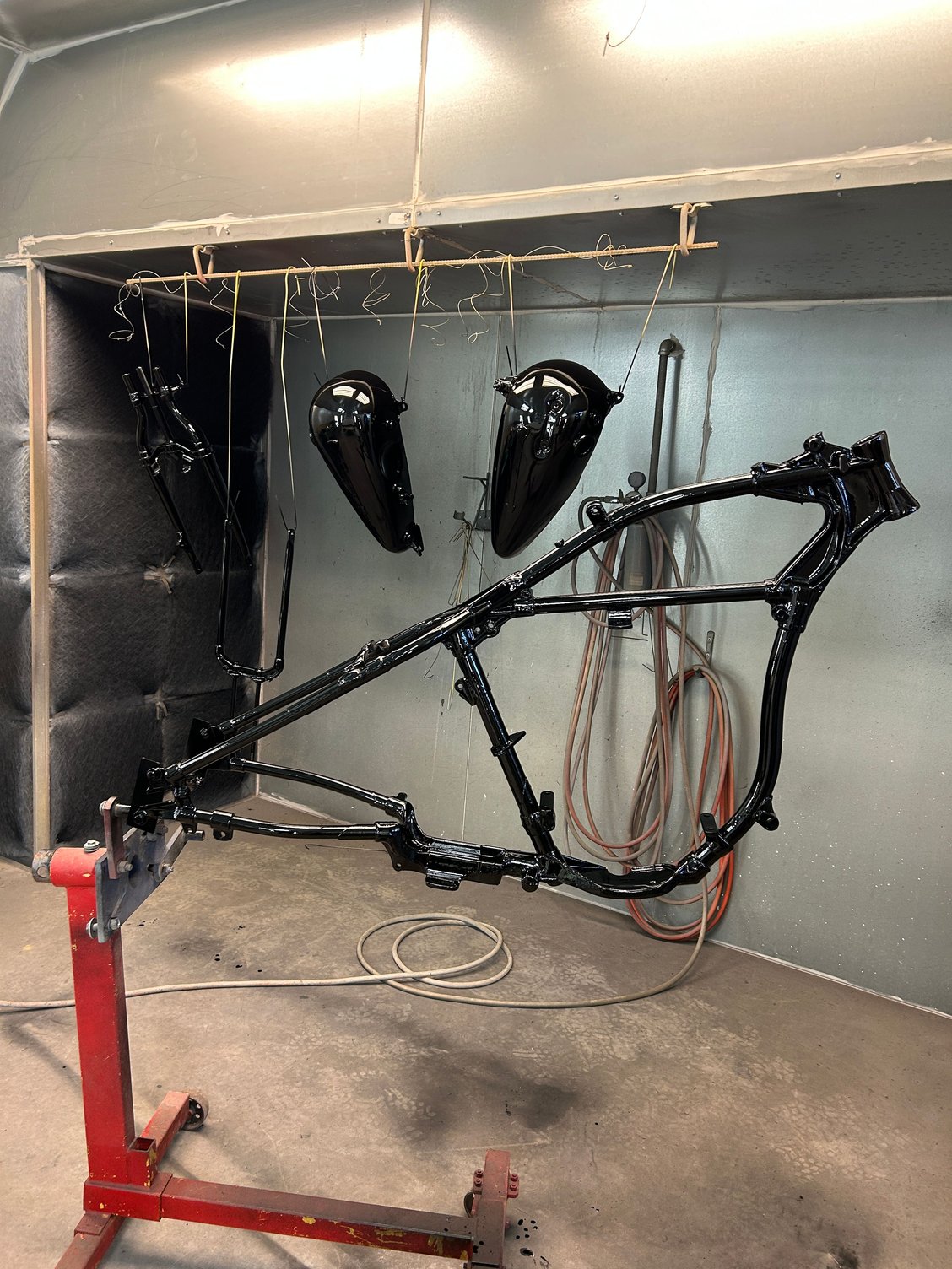

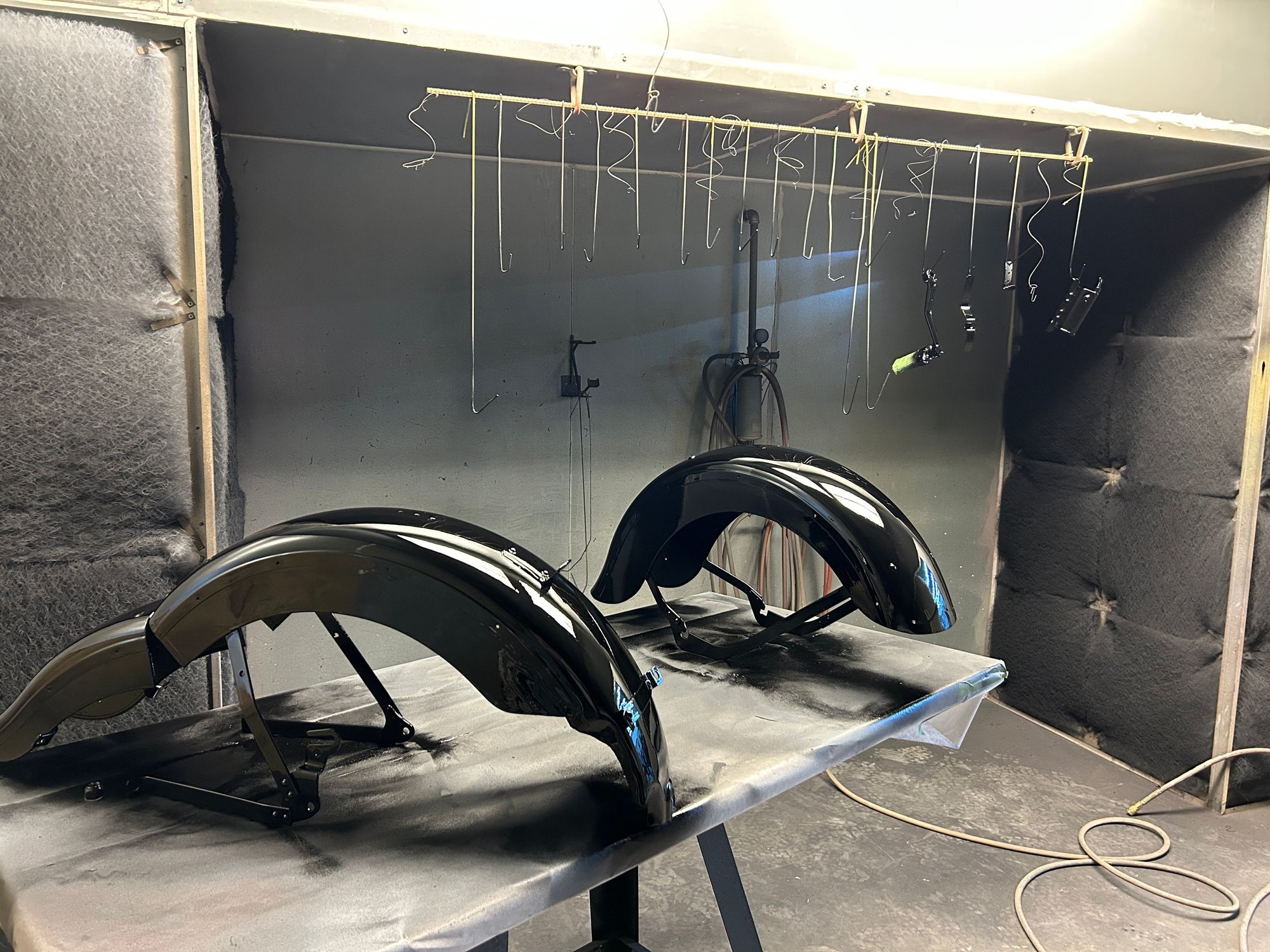

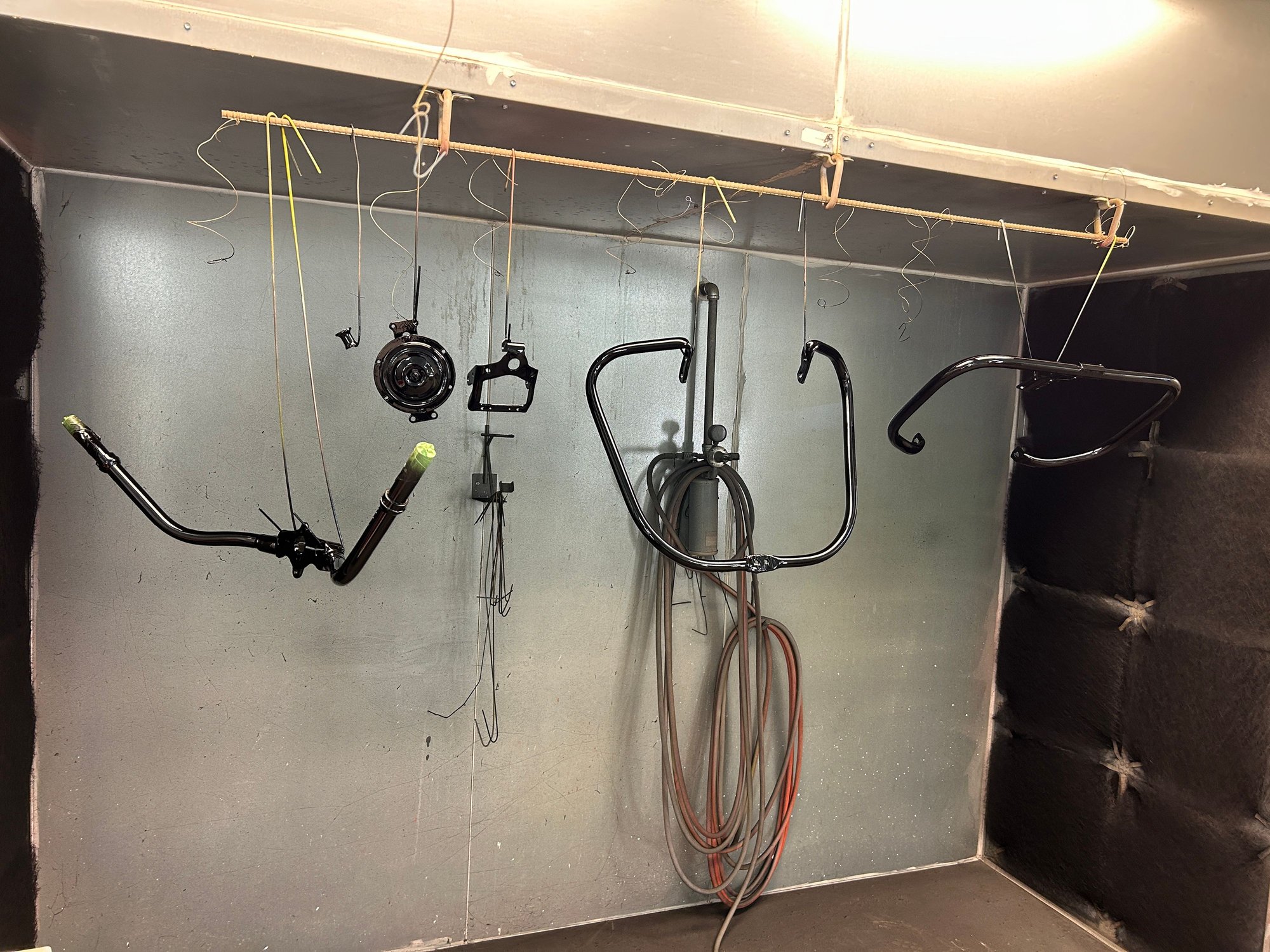

painting the fenders and some other parts

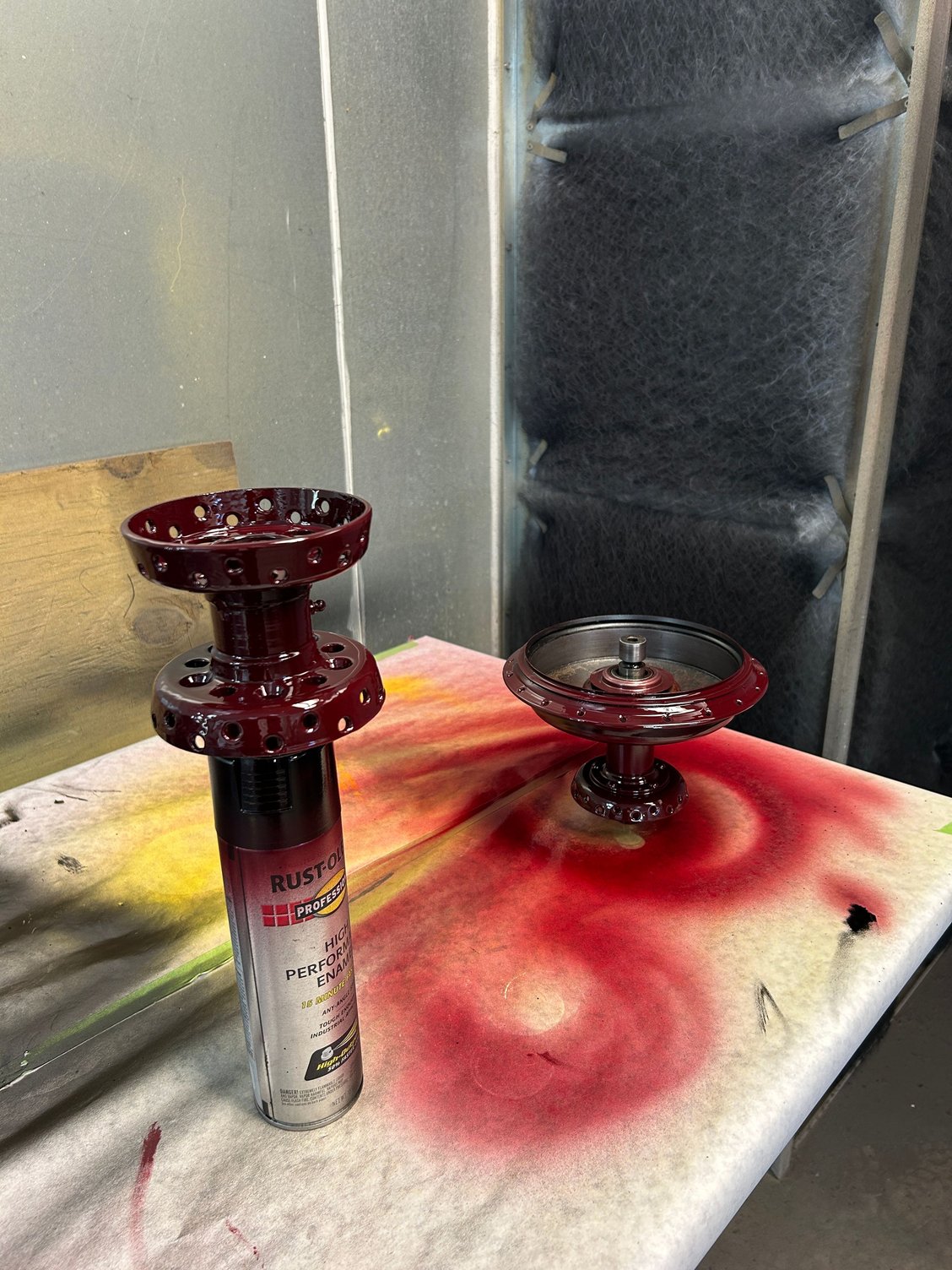

Painting the hubs  as I know they didn't come stock but it her bike and she likes it !

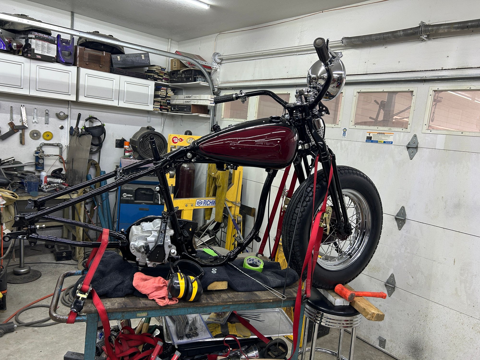

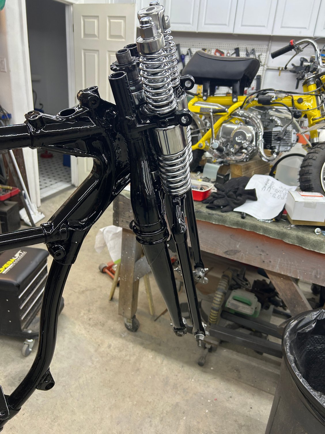

Starting to put it together
Painting some more parts as I find them in the boxes !

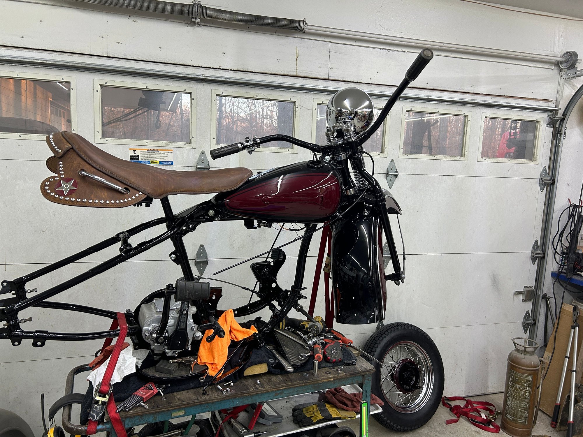

As it goes i hope you like the pics of this fun build as I never built a 45 before and the books out there for what the parts are is let's just say a challenge !

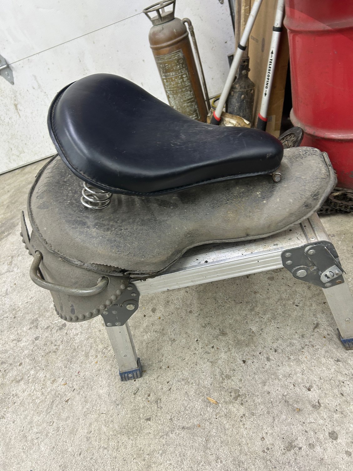

Got a buddy seat with it and a solo seat

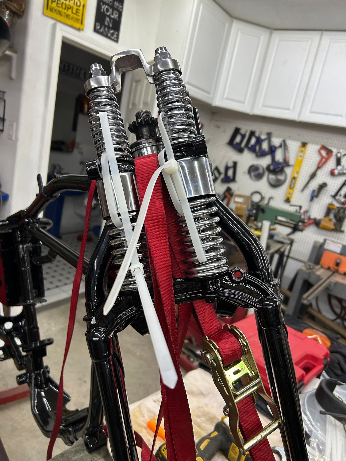

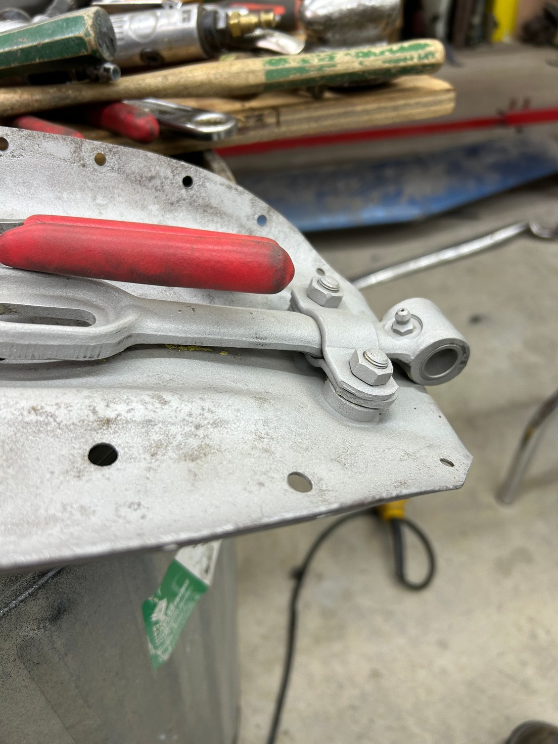

Found out I left the under side jam nut off and have to take it apart to put under the tree cover  used tie straps to keep it together !

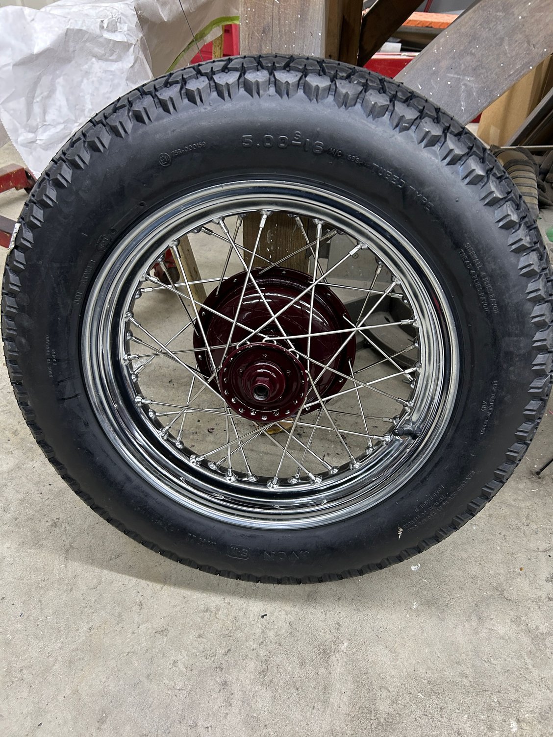

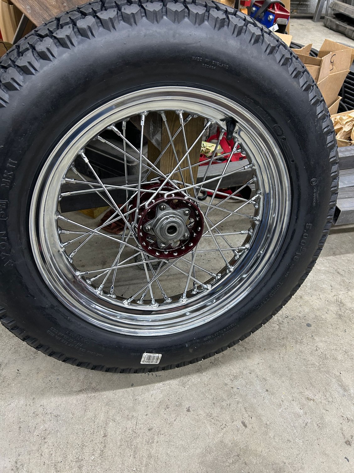

Default 1949 WL 45
rims and wheels done with rear hub painted and new spokes
Front wheel done
Front wheel done

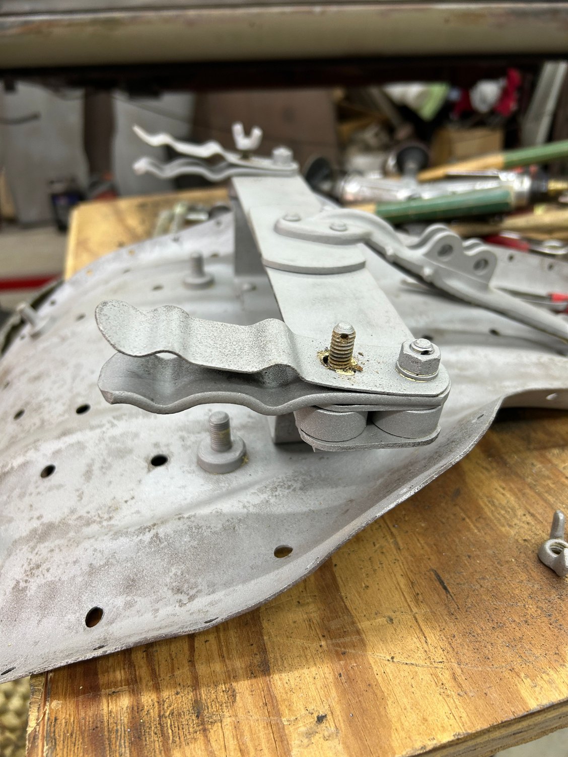

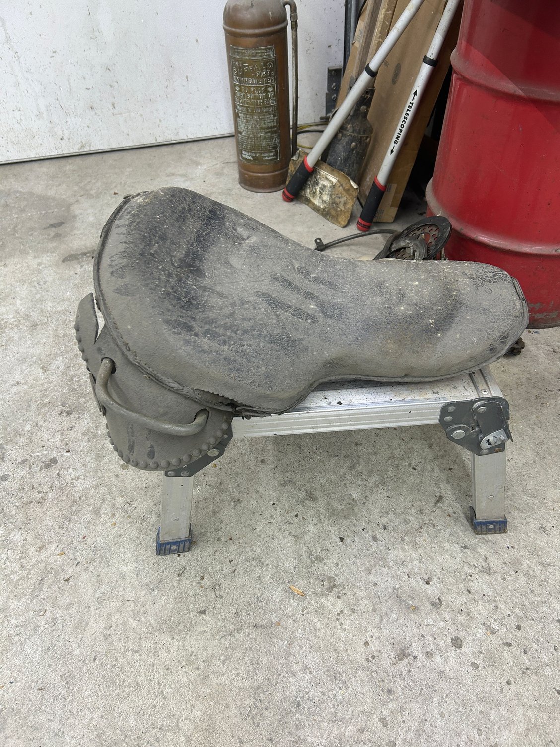

Taking the seat apart and bead blasting it
Had to bent the lip up as it was bent

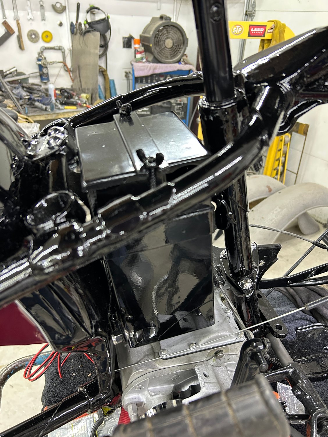

Putting in the battery box

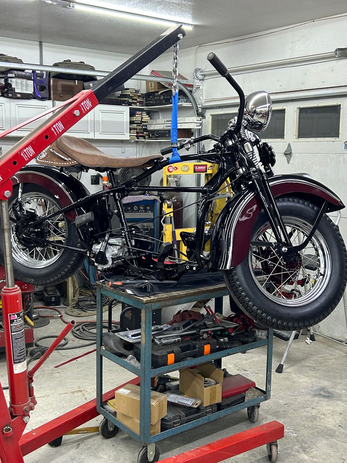

Picked up the engine today from the builder in Lancaster,S.C.
Yup time to get it off the table and on the floor as it's getting a little scaring on the cart !
