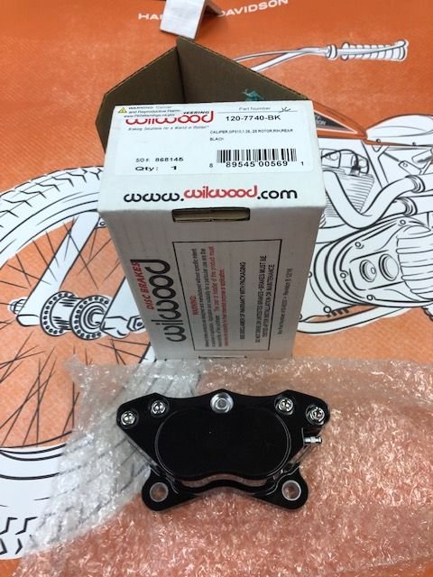

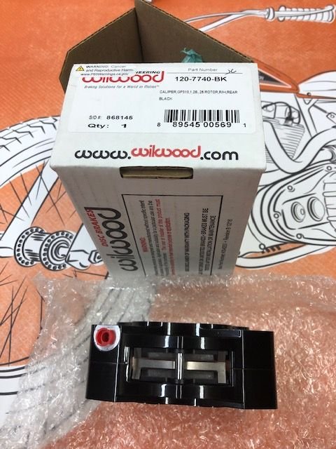

I have this N.I.B if anyone can use it.
$150 shipped CONUS.
