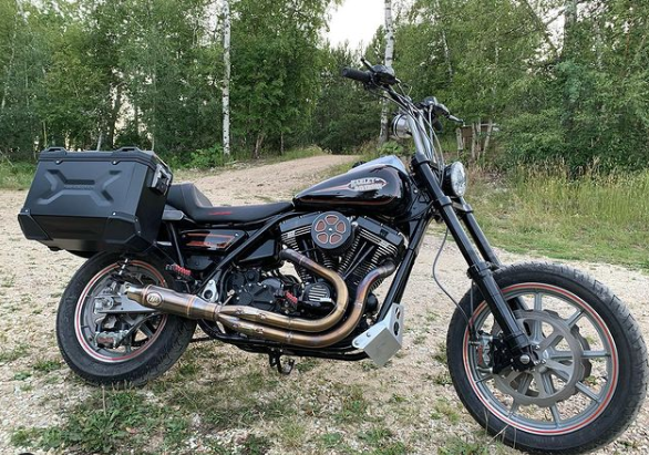

My brother owns Bare Knuckle. Glad the parts are working out for you!! That kit definitely tunes up the ride. Just finished this one up before making it's debut at Sturgis. Gotta love the FXRs.

Killer bike btw! Really dig the setup on those wheels
