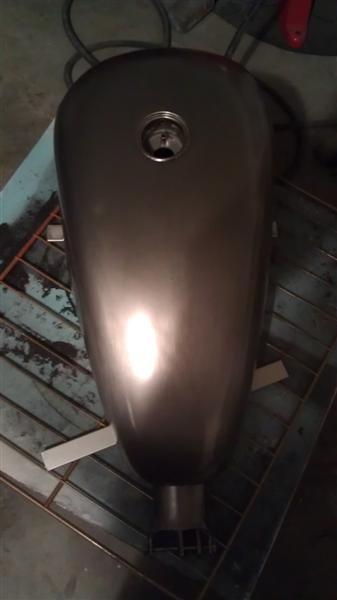

Here's a tank I did that came out pretty unique. Its bare brushed steel with 2 layers of clear powder coat.
