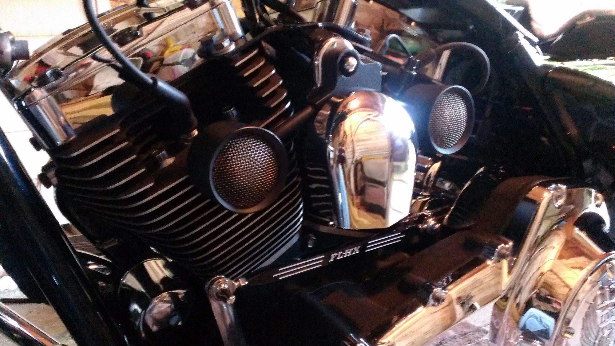

One of if not the best worthwhile add on I've put on my bike. Head temps in summer gridlock were in the 320's, With Wards FCS never go over 245* and averge 230 while riding.

I have the Wards Parts Werks fans on my CVO.
I have the thermostat switch and they do not come on until the heads reach a certain temperature.
When I shut my engine off, the fans usually keep running for about two minutes but maybe a bit longer if the bike is good and hot.
I also have a factory oil cooler and my oil temperature (I have a dipstick thermostat) usually reads between 230-240 degrees in 75-80 degree temps.
I'm very happy with the fans.
