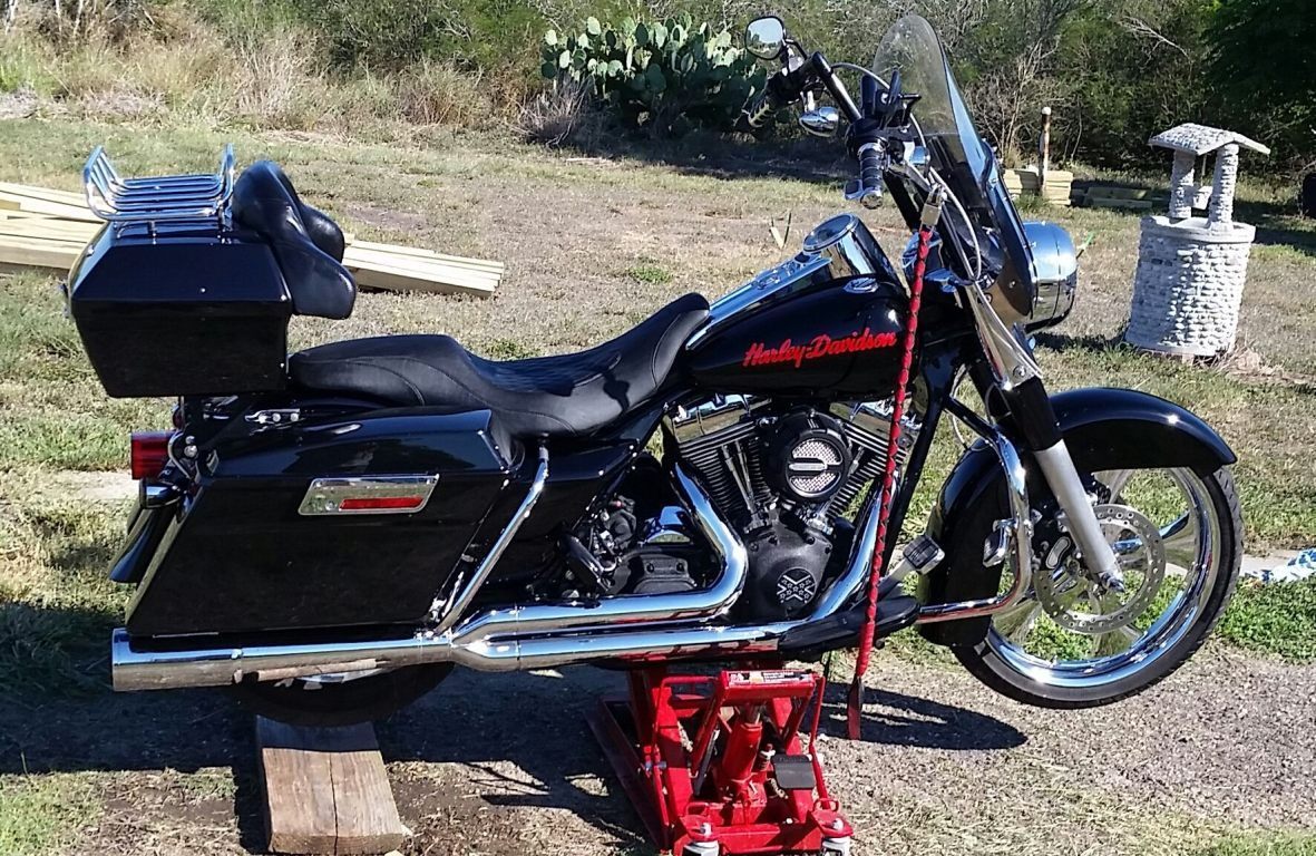

OK I am sure there are many opinions on this. I have 2006 Road King Custom that I just did a major upgrade to.
Am switching the saddlebags to the new style, getting a real tour pack and also adding a batwing faring. The engine is solid as I just rode it on an 8,109 mile trip but am looking to do some engine upgrades.
Still has the spring type cam chain tensioners so the options are:
1) Upgrade to the Harley Hydraulic cam chain tensioners with the upgraded oil pump and cam plate then while in there add a set of Andrews 21TW cams.
2) A complete S and S 510G gear driven cam kit.
Bike now has 35,000 miles. The chain tensioners had very minimal wear at 26K when we did the upgrade. I have no idea about the runout on the crank which appears to be the issue when switching from chain driven to gear driven cams.
I have solid bike knowledge but am no mechanic. Every shop I have talked to has a different opinion.
I had considered the Feuling chain driven cams but the fact that the tensioners are not included in the kit kind of swayed me. Lots of people here run the 88TC so what is everyones opinion on this? Thanks in advance for any advice.
