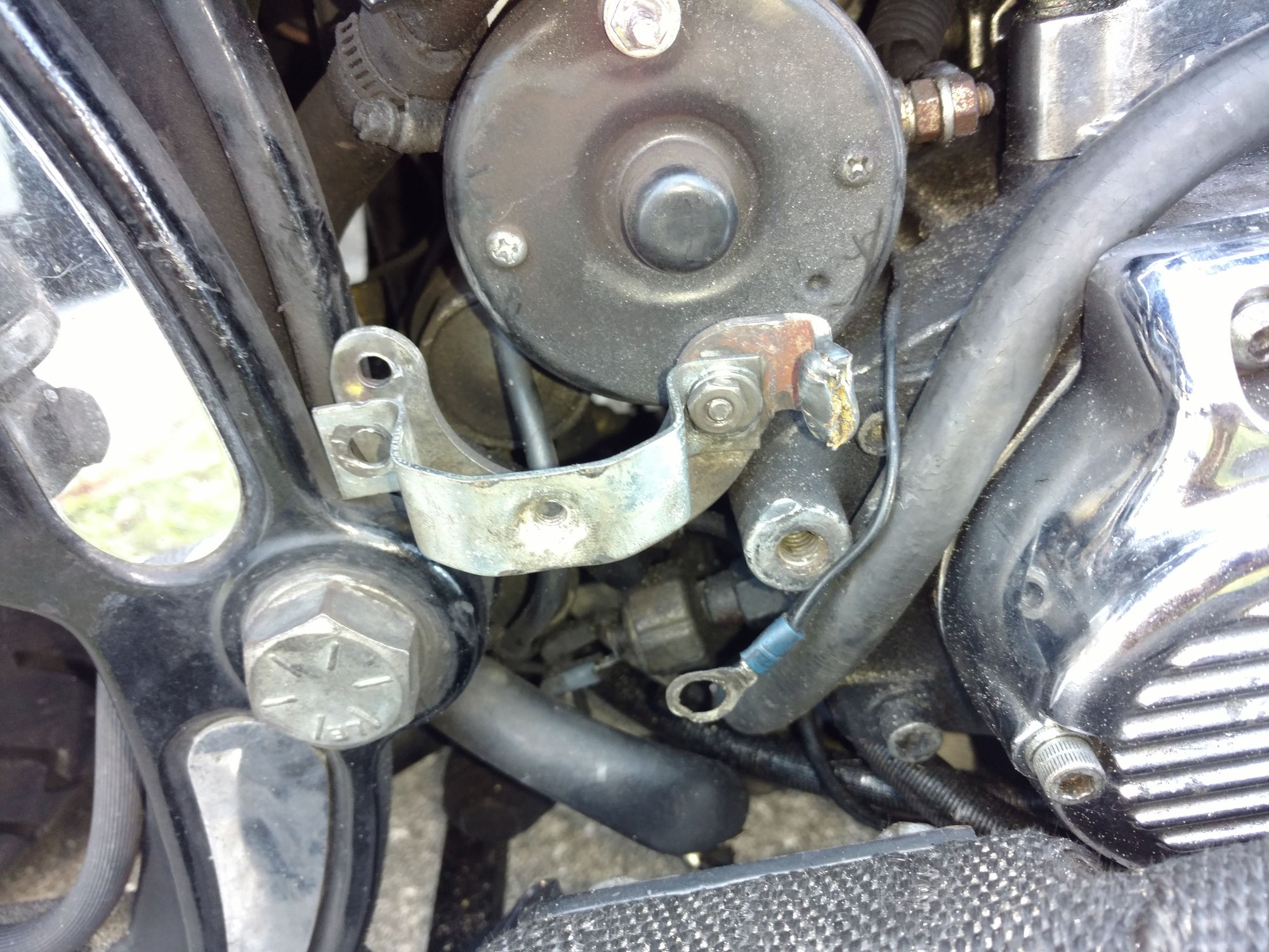

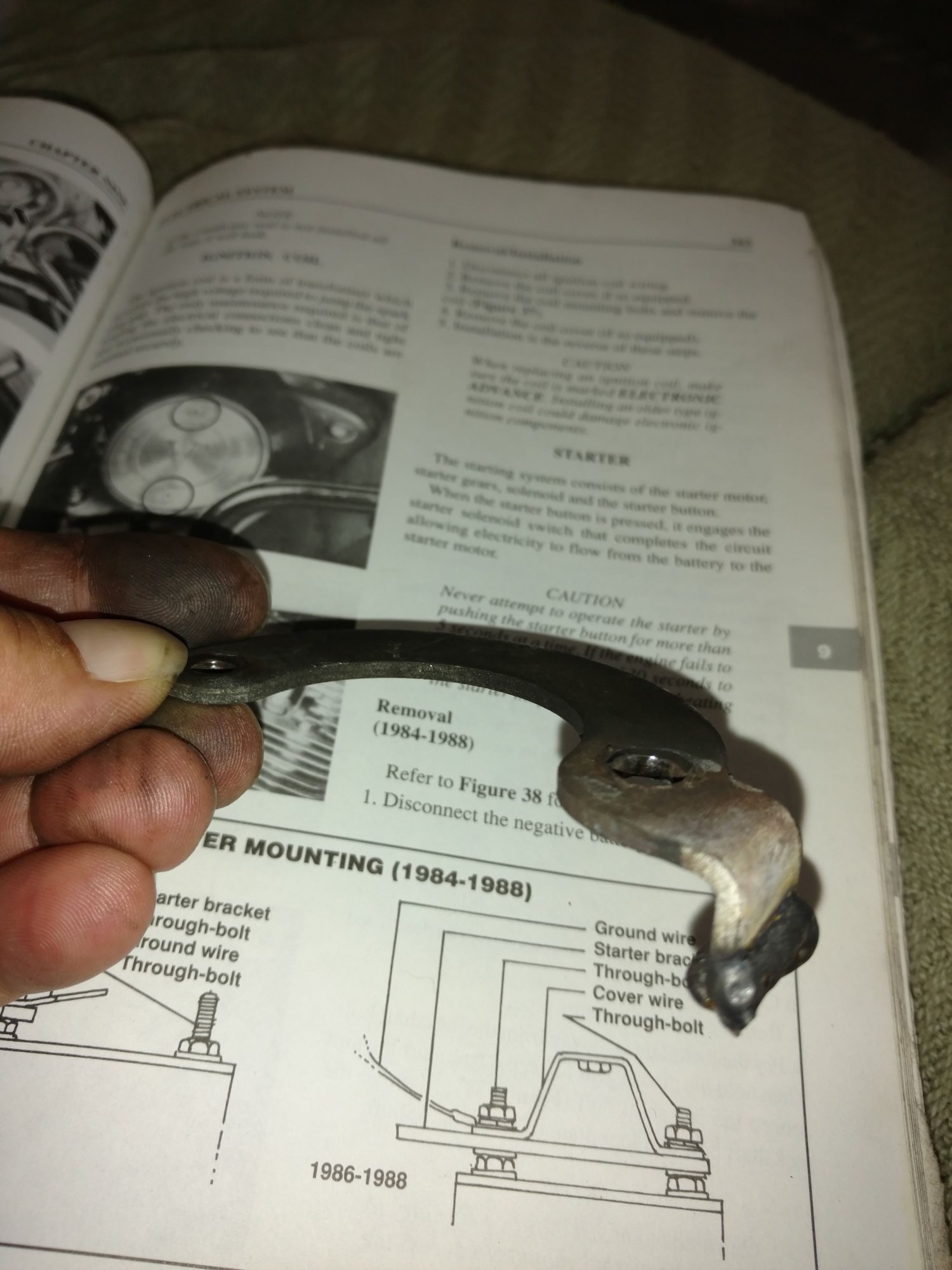

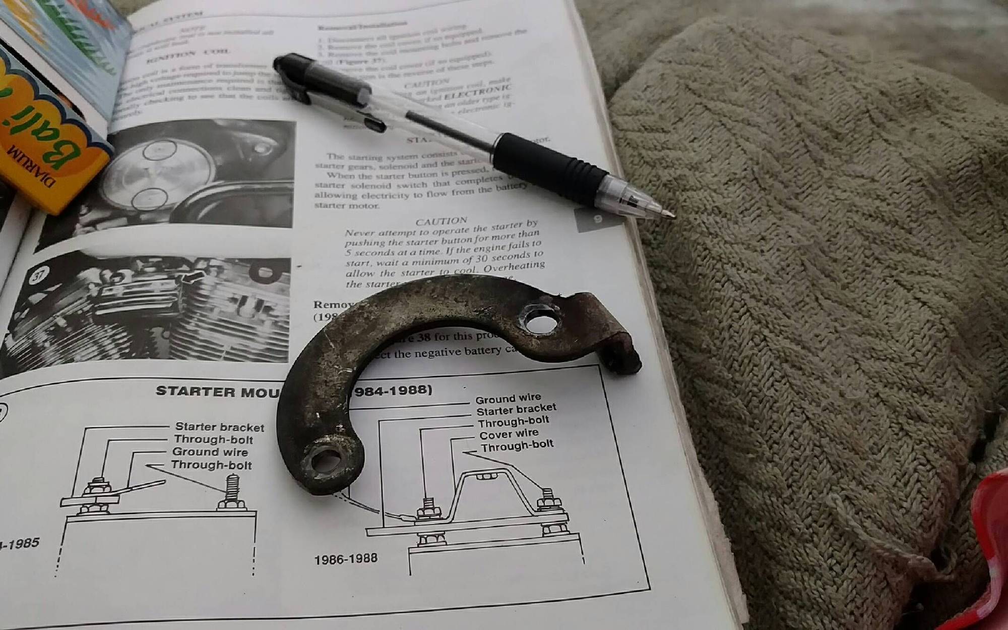

Heard a tinkling last night...found this when I took off the cover... I can have this bracket that was welded (????) Overnighted but Jps is saying the part doesnt fit...???? Should I just order it ...it looks like a match to me?? And the bolt holding on the ground wire is gone...jeez...how do I find this bolt??? Leaving for Daytona on Thursday...dont wanna be in a cage!
Match??
Bolt is gone holding on ground wire...where can I get one quick??

Take the bracket to a hardware store or Lowes and find a bolt that fits.

What is best for you? Run to weld shop or order? Minimum on a weld is what, $40 and up?
Hell, the bolt you match up at the hardware store, as Izzo suggested.

That bracket looks like it has been welded before and broke at the weld. Might want to reinforce it if you decide to fix it.
As stated above just go to Home depot or Lowes with the bracket and find a bolt that fits and get a self locking nut to work with it. Also as OlAndrew stated go over your bike and check everything. Loctite is your friend!

Probably too late to help, but the HD part # for that Hitachi starter bracket is 31479-83. That crosses to the J&P part # 380-845. If that is the J&P part in your pics, it will fit. Looks like J&P made a mistake.
Also, there should be a flat washer between the bracket and mounting hole on the tranny case. If the washer isn't there it will stress the bracket and that could've been what led to the original break, especially if the starter through bolts were ever loose.
