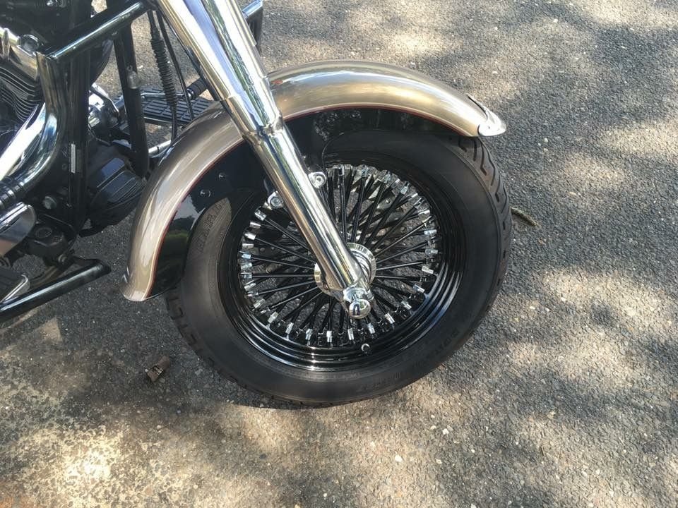

I saw a guy in front of me one day whose back end of his bike was "walking" around to the point I thought he might crash. When he stopped, I pulled up and asked if he was OK. It turns out his spokes were so loose, the wheel was barely connected to the hub. I know you said Fat Boy (solid wheels), but you also mentioned something about changing them. Are you on spokes now? Check it out...it was scary watching that guy ride.

I changed them to the fat spokes I didn't check that but I will. Thanks.
I was rereading this thread and this is what I was thinking as well.
