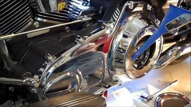

Primary is usually 26 oz.
Fill it with the bike level, like this:
To this level:
