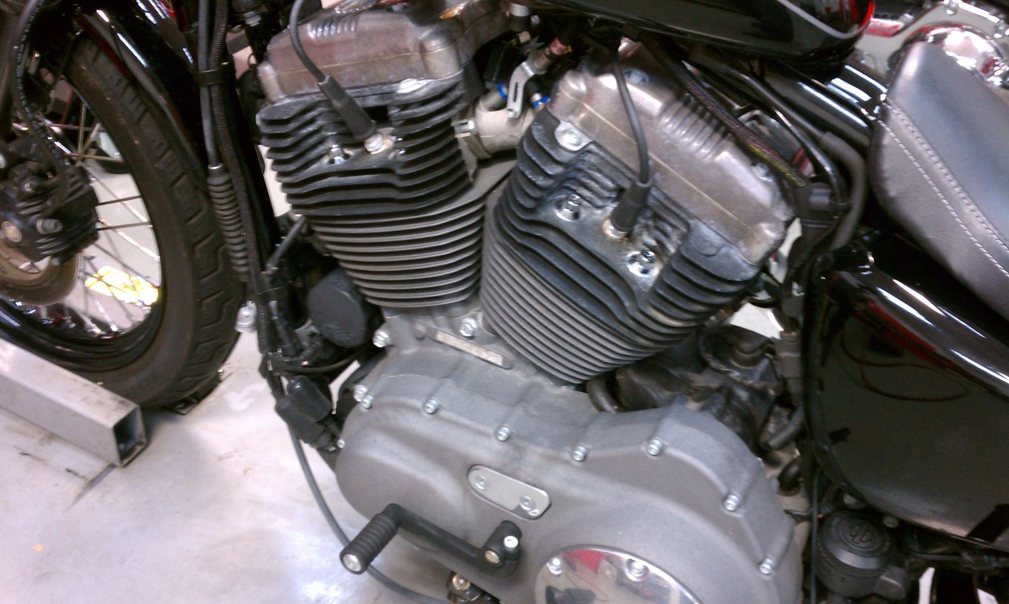

Easyoff f's cheap chrome and powder coating as in those Sportster pics. Never Dull will scratch if you scrub hard enough as will OOOO steel wool.
I've always had good luck with Blue Away powder. It too will scratch if you mix it too thick and use a lot of pressure. They make a liquid cleaner and polish also but I've found the powder to be better.

But, but, but somebody on the internet said it was a good idea!
Originally Posted by From_Behind
I always wondered this, and a few years ago my concerns were confirmed. I was at the dealership for something or other, and somebody brought this bike in. The owner had the bright idea of using Easy Off to clean his bike

Easy off will strip anodizing right off, and etch the aluminum in the process. It's a great thing to do if you want to get anodizing, clear or otherwise off to polish aluminum. I used it to strip a set of Porsche wheels prior to polishing and accent painting. Probably what happened to that Sportster. It's also great to use to clean and etch aluminum prior to welding!
If there is still plastic residue, it's probably best to follow advice in previous posts. Get it hot, and used something softer than steel to try to rub it off. Patience is the key. You can still rub to hard and damage the chrome.
Sometimes the best course of action is no action at all. Many times trying to remove crap will make it worse. Eventually, it might burn off.

I've used Easy-Off to remove boot marks for years and never had a problem. Some precautions are necessary. First, the stuff eats aluminum. NEVER spray it directly on the pipes or anywhere near your bike. Overspray will etch anything made of aluminum instantly. Spray a bit on a clean cloth and rub it on the chrome pipe. Try it COLD first. Don't leave it on the pipes and walk away, just use the dampened cloth to rub off the marks. Remove any excess with lots of cold water.
As for steel wool, sometimes it works and sometimes it will scratch. It depends on the quality of the plating.

To clear things up Easy-Off comes in a cold or no fume formula. Blue/silver can iirc. That's the one you use for pipes and leave it on overnight. Do not use Easy-Off for hot Ovens. That is corrosive.

Maybe that's where I screwed up. I didn't wash it off, I just wiped it off.

Easy off will strip anodizing right off, and etch the aluminum in the process ... Yep, I used Easy Off to remove the factory coating ( Gold Anodizing ) on the wheels of my Ice Bike. The way I figured it, if it's strong enough to remove the coating I sure don't want to use it on a finish I wish to save. Afterwards I polished the wheels to a brilliant finish.
