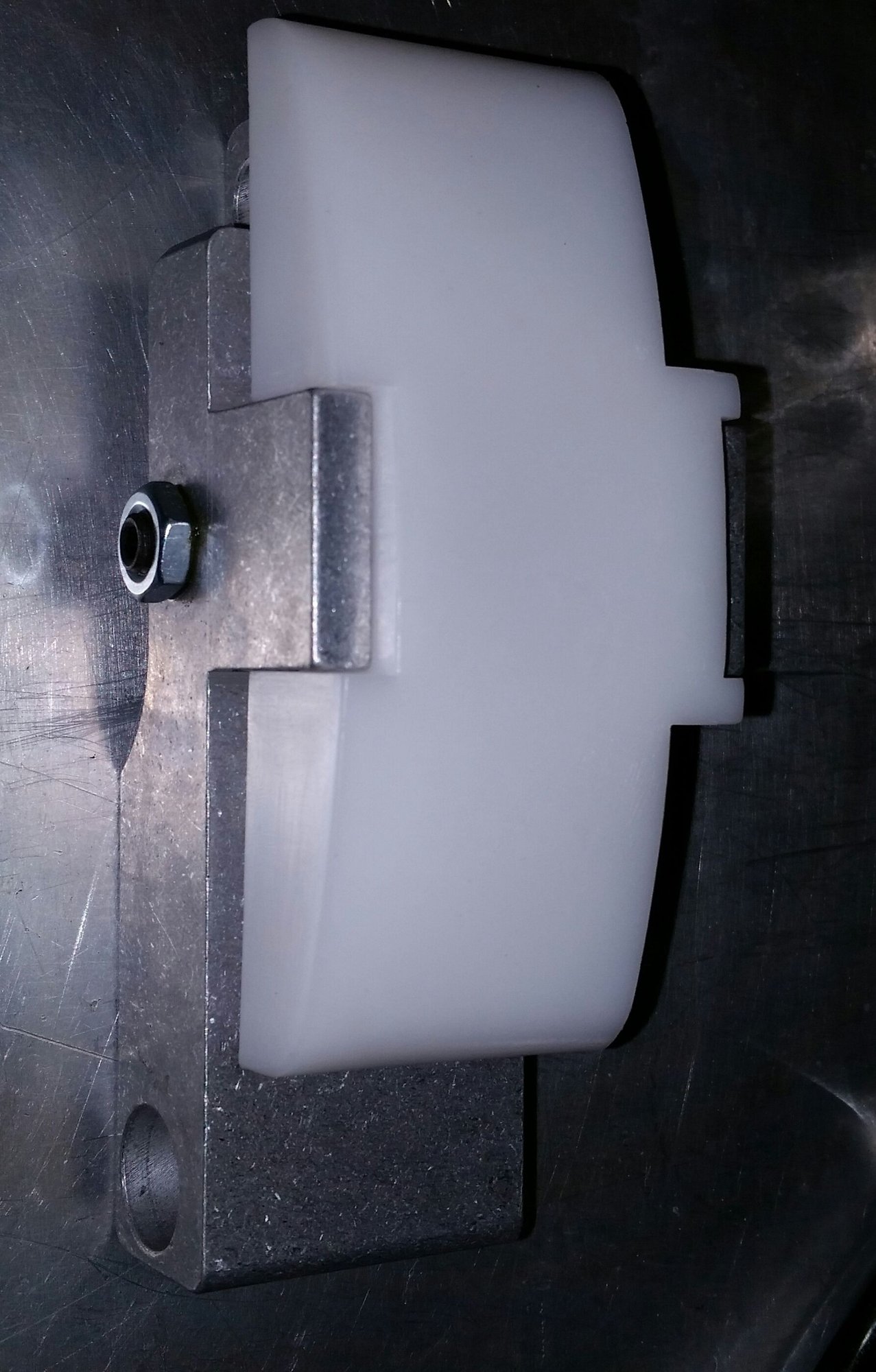

Received and installed the SOHB HB125-07 hydraulic tensioner today. Installation was fairly easy, worst part was removing the compensator to get the Baker adjuster out.
Pros:
It's a good concept and pretty well executed. Simple and looks like it should last.
Really quieted down my primary, no noise at all. The Baker manual adjuster I've had in there for the last year would whine on decel. It was very noticeable in the lower gears.
Cons:
No instructions at all, just a box with the adjuster inside. No receipt either.
You have to watch a 10 min YouTube video to learn the finer points of installation. A simple 1 page instruction sheet would be nice.
​​​​The only other con is that they provide 4 small washers to space the adjuster out about .090. Why they don't just make the adjuster base that much wider, I have no idea. I didn't care for the small washer idea, so I turned up (2) .100 thick x 7/8 dia. aluminum spacers. They'll give better support to the base block when mounted to the inner primary housing.
After a short 40 mile shakedown run, I'm happy with the results. Barring any problems, I'll see how it looks during next year's service.
