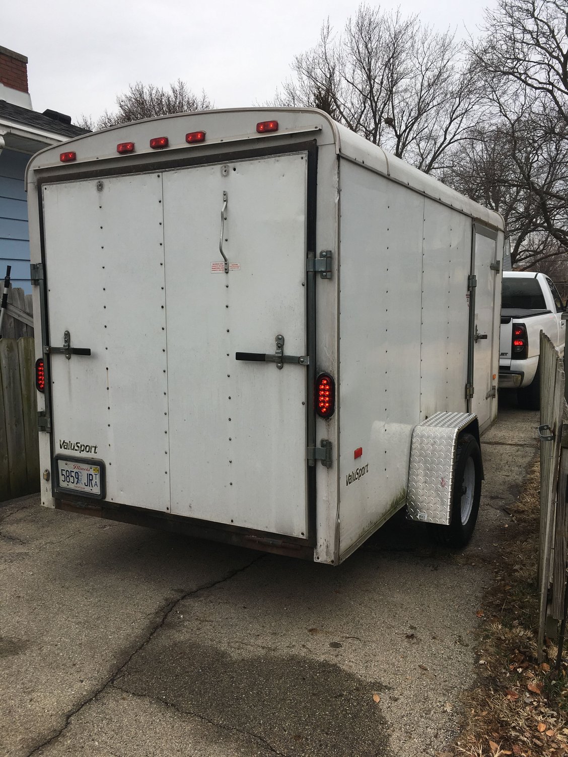

last week i picked up an 2008 Electra Glide, today i picked up a used 6x12 enclosed trailer to keep it in when im not riding it during the summer (no garage space) but thinking it will come in handy for hauling it around at times to but there is no tie down points in it so looking for tips on setting it up to secure the bike down when in tow
whats a decent wheel chock? D rings or E-track?
not looking to impress any one just make sure the bike is safe when being trailered like to keep cost down to spend more on the bike itself
please feel free to post your trailers

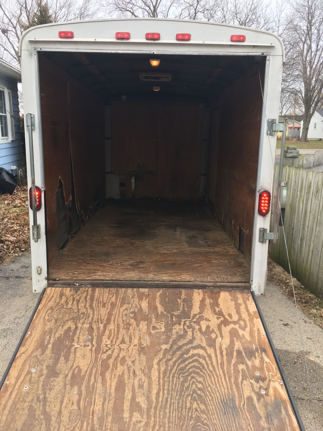

Biker Bar looks pretty cool and simple but this is trailer will probably be mostly bike parking with other use's to and it would be in the way, was looking at the harbor freight chock but didnt know if it was any good, looks like i'll grab one!
trailer has a 2"x3" tube frame 24" centers for the cross beams might have to weld in some angle iron peaces to have the D rings or E track tied in to them
pleased with this trailer for $600 brand new tires all the lights work and doors are in good shape, inside panels need to be replaced and i might install a new floor this one is still ok but its only i think 1/2 thick and with 24" centers i'd feel better with 3/4 or even 1" down there, rear stabilizers and a really good cleaning

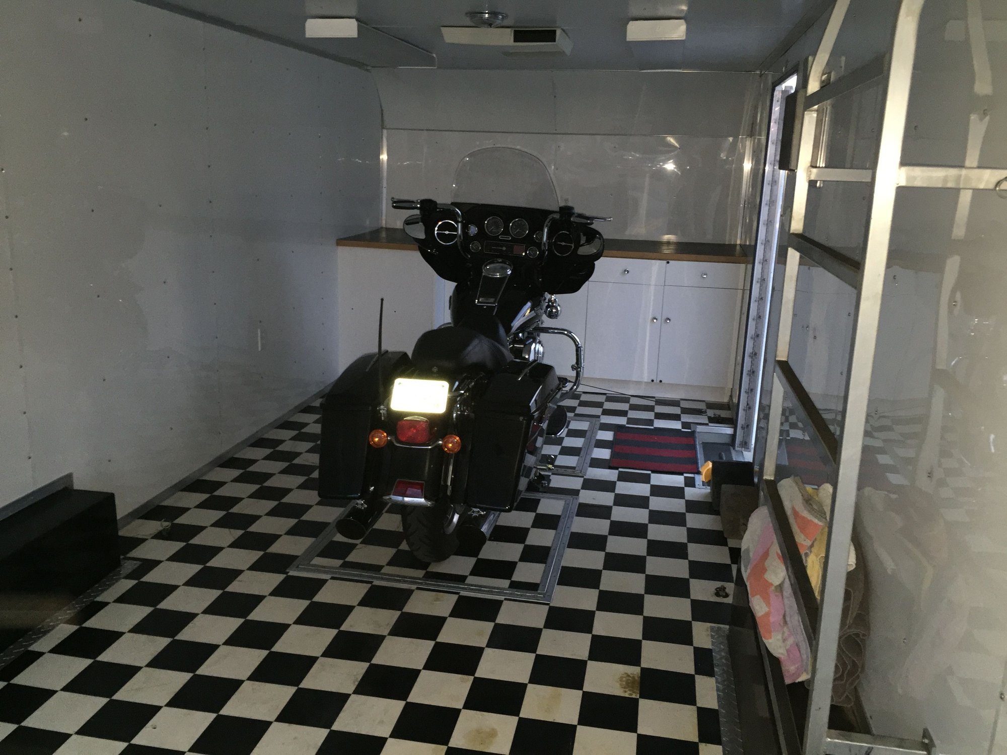

Sold this 24’ but will pick up a 8.5x14 Friday. Still going to use the Biker Bars and they are easy to remove the mount if you need the floor space. It takes 30 seconds and they are gone, 30 second and installed when needed.

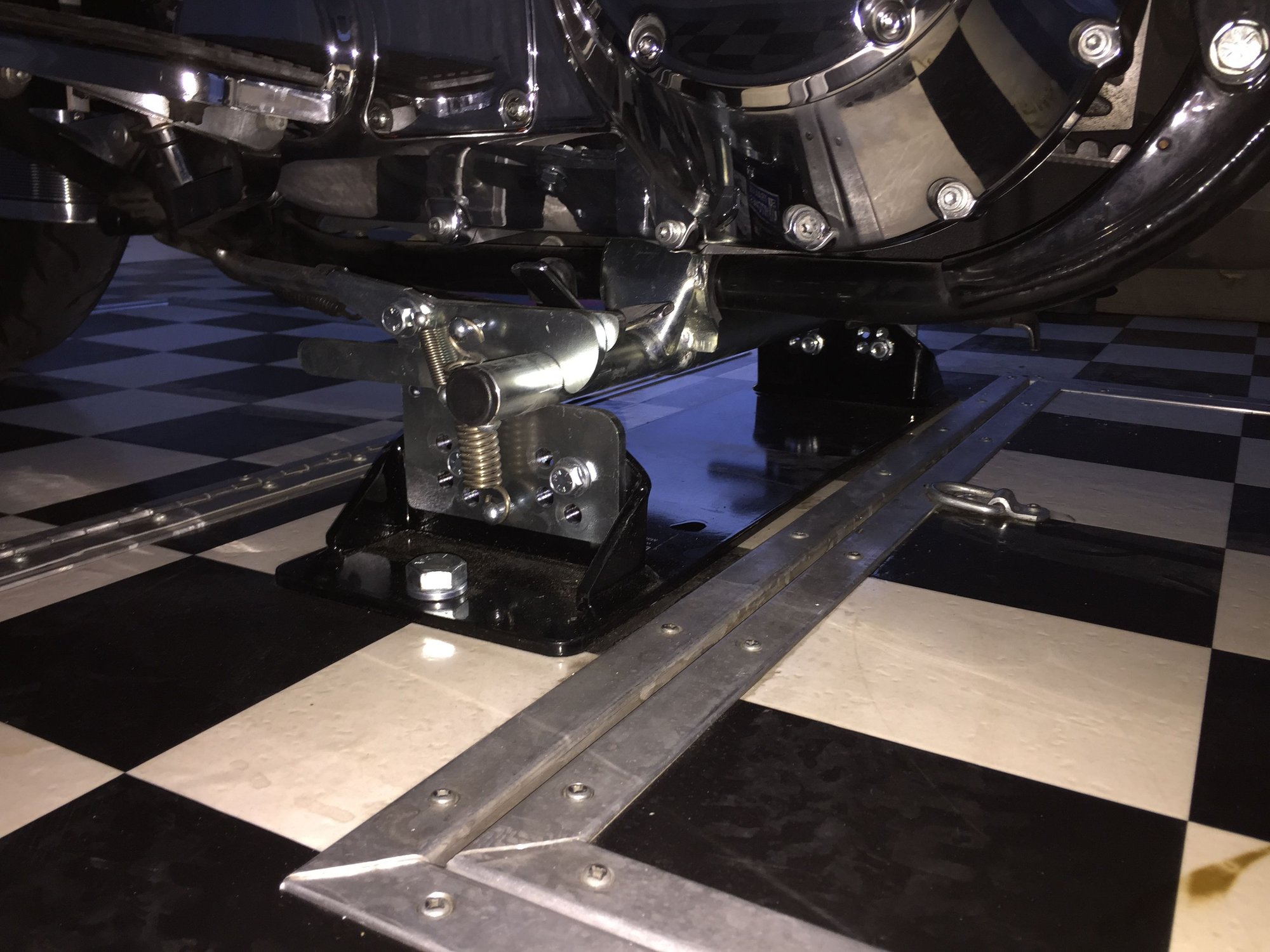

You really want overkill?
Forget Harbor Freight.
What you want is Pitbull.
Attached Thumbnails setup enclosed trailer to haul electra? show me your setup?-photo302.jpg
