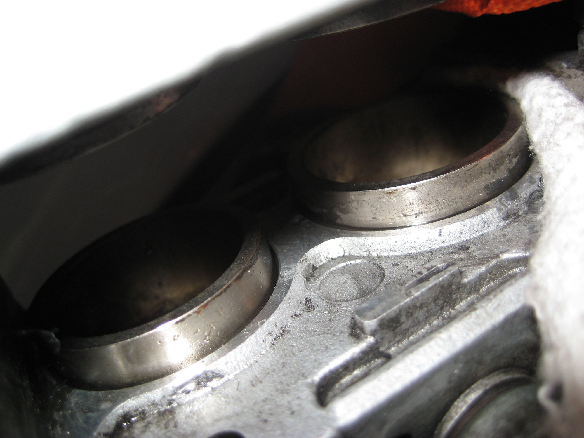

Bravo, can I coin the term caliper flossing? Rotors should last a long long time. Dare I say life of the bike when the pads and calipers are in tip top shape. Change the brake fluid also. I get a new set of pads for 18 dollars and yearly replace them with a good "caliper flossing" on my geezer glide. I do not care if the pads are not ceramic or whatever as long as they feel good and last 10-20k miles.

Here are some pics of flossing on a 1995 FZR600 yamaha.
