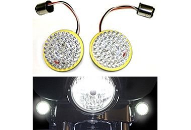

I could understand the theory of not using the grease on the internal connections to the LED itself. The LED parts are inside the signal housing with two wires coming out connected to a plug that is identical to the 1187 light-bulb plug. I am no electrician either but it would make sense to me the higher current draw is inside the hard wired LED light assembly not at the plug.

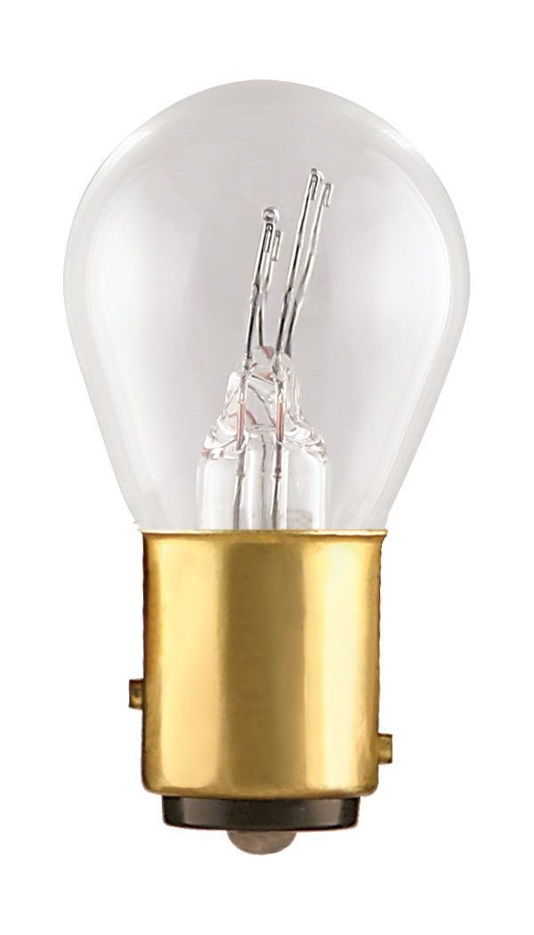

Typical 1187 bulb.
Custom Dynamic LED replacements
