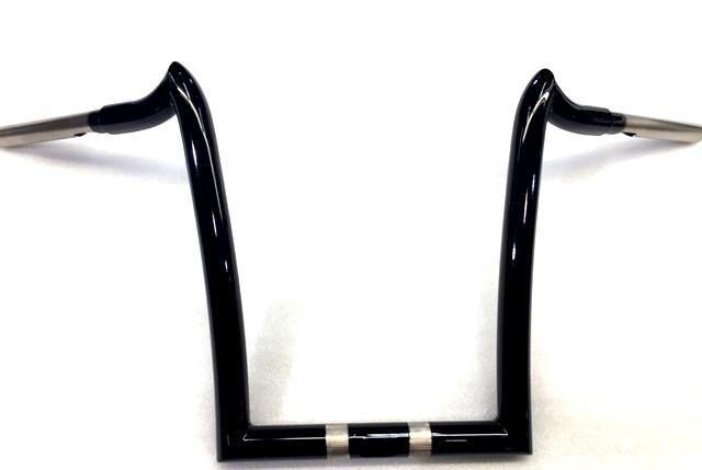

This is precisely why I started the thread, to help folks going forward. Problem is not many folks have an endoscope. You would be hard pressed to find this with just a flashlight, actually nearly impossible with the style of these particular bars. I lust happen to like the style as opposed to the smooth bend types.
They are pretty much the same style as Yaffe bars, at least close. Yaffe are just wider than I prefer. My Indy will be actually cleaning the inner roughness away to a smooth finish as such a bar should have. Issues down the road are not going to be a problem for me because AGAIN he is very thorough. Here is exactly what the bars look like.
Almost exactly as the Yaffee's bars. Got to tell you getting the wire harness to go past that peak, is not easy, and there are two on each side. The best thing I found in running the wires in any type of bar, is use the inside of an old speedometer cable from a car. stiff, yet very flexible, and strong enough to really grab on to. Tip for the day!

Good tip Charlie but my Indy uses another approach that takes any pulling or feeding issues out of the equation. Simply use compressed air to blow a strong string through. This guy has been working on Harley's exclusively for well over 30 years so to say I trust him is an understatement. I am pretty sure (?) mine may be the first M8 he has taken on with as much as I gave him to install, a BUNCH. That being said I saw he picked up a service manual for the new bikes. Just glad that over the years we have become friends.

The difference in a welder and a dobber.
Worked for a GAS company welding pipe for a few years. Got called one day to help pull a road crossing, so I welded a pull plug to the end of four joints already welded by someone else. My crew started pulling and I heard a thud - MY pull plug and the first joint was pulling and the rest stopped.
Needless to say I welded a pull plug on the other end, pulled the pipe out, and dug up all the pipe that person welded.
You're concerned about pulling wires. You realize your life depends on those bars not breaking when you accelerate, corner, or brake hard.
