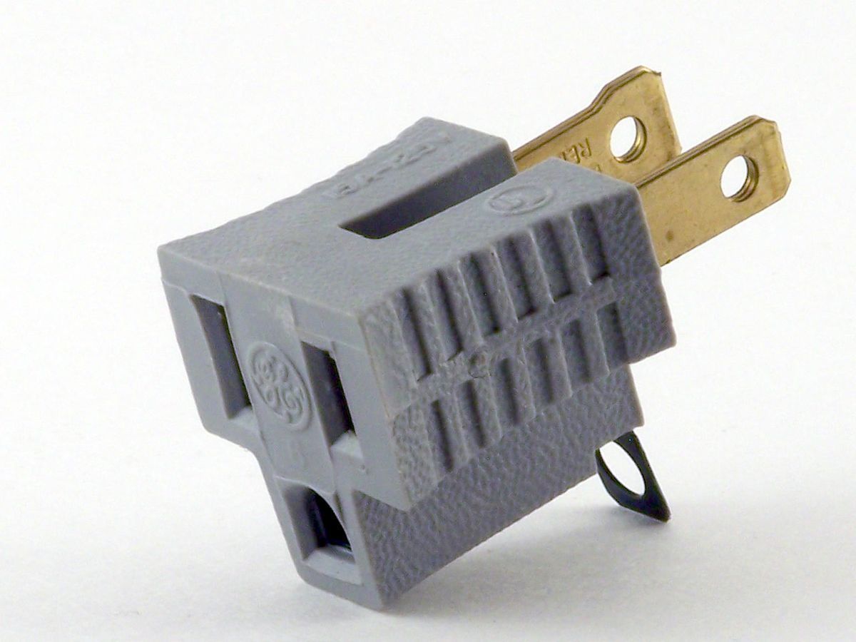

Something as simple as condensation will pop a GFI...if it does it again betcha it will work if you use a ground adapter "cheater"
Funny you mentioned this...it has been so humid this week you can cut the air with a knife. And it rained cats & dogs yesterday. I had a thought that once things dry up the problem might go away.
