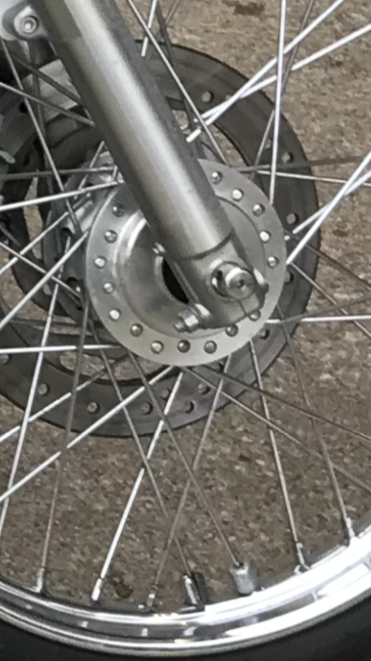

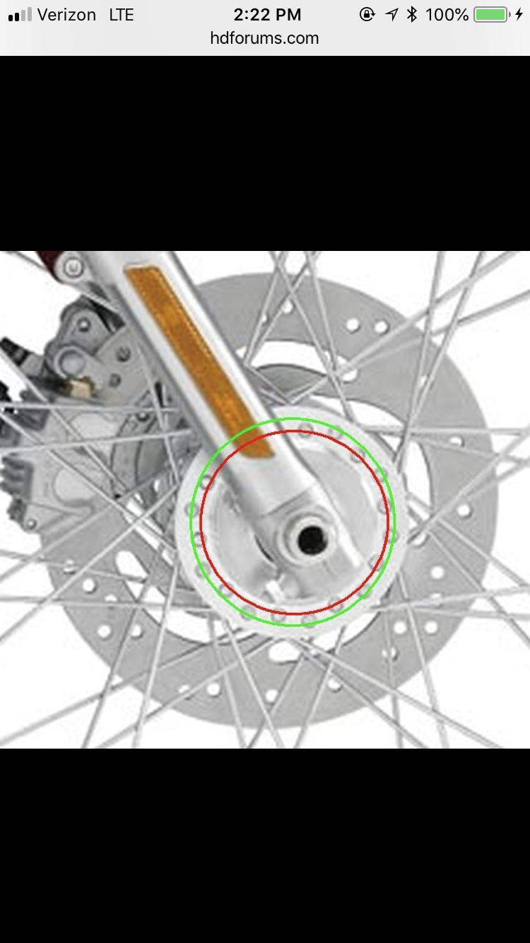

Hello all,
Hoping someone can provide insight to my current dilemma. I have a 2006 Sportster custom, I recently decided to do a wheel swap from the stock 21” to a 19”. The question I have is if I can use my hub from the 21” and lace it using the 19” rim and spokes? One thing I have noticed is that the hub from the 21” is a staggered eyelet patten, whereas the 19” has an in-line pattern. Does the 21” staggering affect the pattern layout? Both the 19” and 21” use 40 spokes. I tried to lace the 21” staggered pattern hub to the 19” rim with the 19” spokes but when I do so the threads max out on the outer spokes, which then doesn’t allow them to engage the rim.
Is this just a matter of buying new spokes or should the ones from the 19” rim work? I assumed they would but maybe the staggered pattern of the 21” hub plays a role?
Any advice helps!
- Hunter
21” diagram showing pattern of hub
21” rim with hub (notice staggered pattern) also 40 spokes same pattern.
19” wheel before I disassembled (notice the in-line pattern on hub) same spoke pattern with 40.

Odd, where they 40 spoke? The pictures I included are factory HD lacing with 40 spokes. Would you mind sending pictures and counting the spokes to double check?
- Hunter
