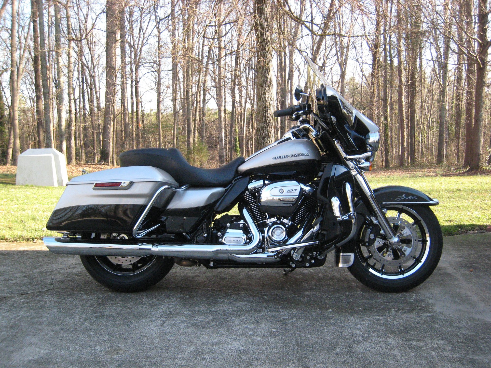

I used the HD removable kit and it is a very easy one person job to remove and re-install. I relocated the AM/FM antenna to inside the front fairing. Although they come with the quick detach kit, I never cared for the light strips that mount to the saddlebags so I used the HD lgts between the fenders and bags.
It's a clean looking set-up with the pack on or off.

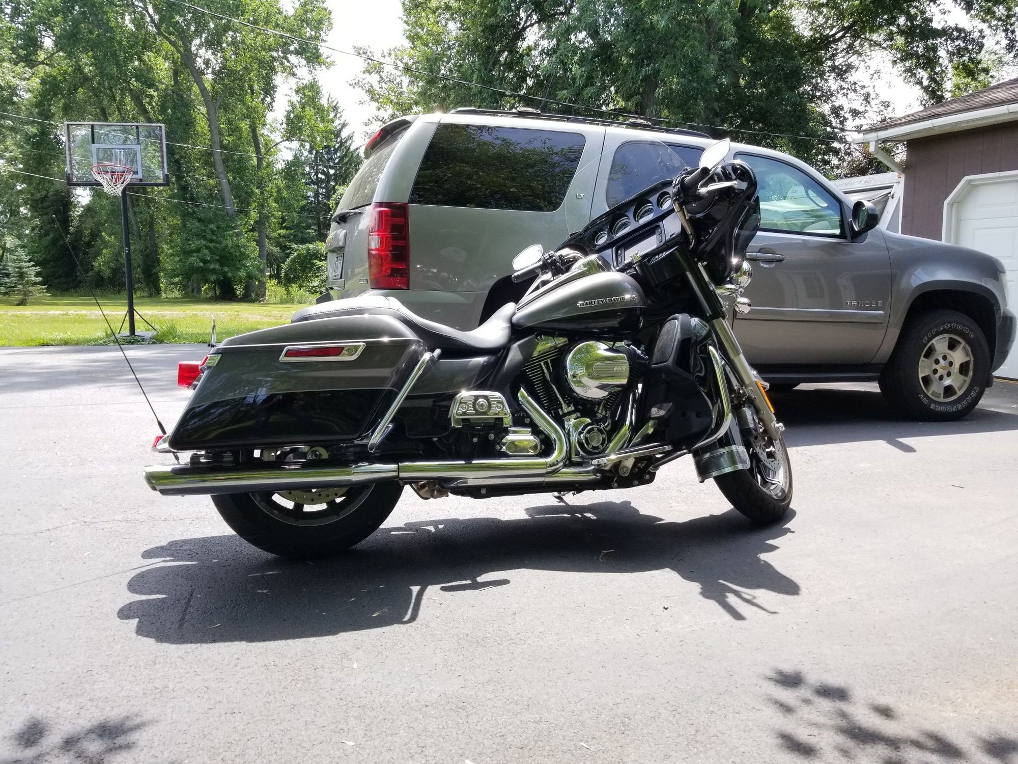

Bought the Detachable Tour Pak kit from Boadtracker for $470 shipped. Picked up a SG seat from a forum member here for $150. Put it together yesterday, took about 3 hrs but I was being pokey. Probably couldve done it in two. I am very happy with the results.
I too like the inserts but I think the bag lights are more visible. Just my opinion.
