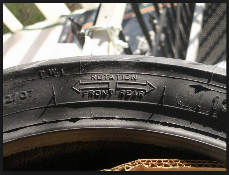

I'm not the most knowledgeable by any stretch of the imagination but I had a bro who had a tire installed backwards at a dealership. We stopped by an indy shop to get my bike and head out, when one of the wrenches noticed his tire improperly installed. They took care of it and the tire had only been installed for a few days. They told us that the tire was prone to "unwind" if ran backwards for any real length of time/miles. Basically... the metal cords in the tire would start to loosen inside the rubber and possibly even bunch up, causing tire bulge. All potentials mentioned were obviously bad.
Being a used bike that's new to you with unknown mileage on that tire... I'd have it swapped out unless it looks brand, spankin' new. Even then, I'd probably talk to the shop that sold it to him and see what they know about it. It would be a drag if they just replaced the tire for re-sale and the shop wrench screwed up. Tires ain't cheap but avoiding a trip in the meat-wagon is priceless.
Of course... my info is hear-say, so handle accordingly.
Old Sep 14, 2018 | 01:20 PM
Tom84FXST's Avatar
Tom84FXST
Joined: Nov 2009
Posts: 15,705
Likes: 22,718
From: Farmington ,MS
Originally Posted by BikerPepe`
They told us that the tire was prone to "unwind" if ran backwards for any real length of time/miles..
I wouldn't worry about it.
The arrows on a tire are to give maximum traction, braking, and helps the tread clear water.
Tires that can be used on front or back have two arrows.
